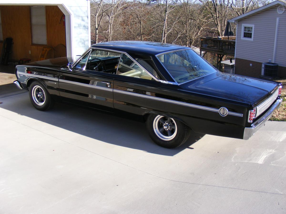

They rub on the outsides. You can almost forget having any passenger in the car with the big tires. I had a front seat passenger in mine and they rub. I have a 11:50x28x15 ET street on a 15x8 with a 4.5 back space. The 275 is the same or real dam close as the 11:50 tire. I have a spool and they rub on any turns if I go to fast or turn to sharp.
so then to be safe and have no rub whatsoever, what size do you think I should run? Most likely, there will never be any back seat passengers! Is that the rear tires you are running on your 66 in your profile photos? beautiful car, by the way!
I'm running 275/60/15's on my 66 Satty. The rims are 15x8. They are on the car that i use as my avatar. PM me if you want more pics and more detail. I did have a small rub issue but fixed it easy with air shocks.

on my 66 belvedere I'm running 15x7 wheel and the largest tire I could run without any rubbing was a 235-70
