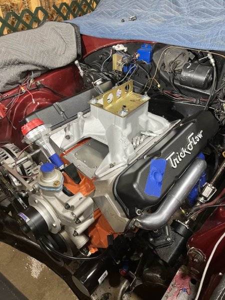

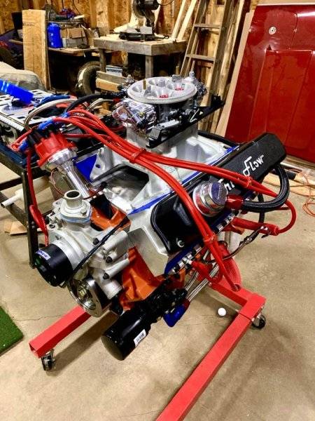

After spending 21 months putting together a 400-512 power plant for my 66 440 Coronet I have the car back on the street. The 400-512 is a 11.5 to 1 stroker with TF 270's, Howards Cam solid 275, 276 duration 645 lift, TTI 2 1/8 headers and Pro Systems 1050 Dominator. MSD Digital 6 plus with MSD billet distributor, TCI full manual 727 with transbrake and 4200 9.5 street strip converter and 4.10 rear gear. As you can guess I built this car for both the track and street. I asked a lot of questions at the start of the build, I figured I should share the end result. Once break in on the motor is complete I'll bring to the local track and post the results.

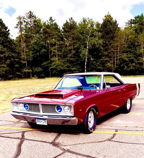

That is super sweet! I'm putting a 66 coronet 500 together and was wondering what the low hemi scoop would look like on that hood, that is wicked!! And I'll be finding one for my car, that's for sure.

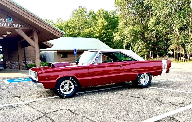

I'm putting a 66 coronet together and have been wondering what it would look like with that stripe on the rear quarter? Question answered, awesome! :thumbsup:
