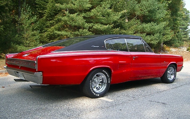

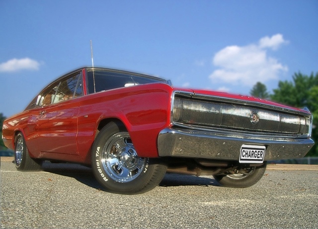

I'm using 245-60-15's front and 275-60-15's on the rear of my 66 Charger

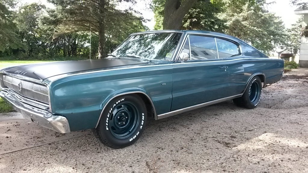

235/60/15 mounted on factory cop wheels on the front. 295/50/15 on 10" wide Stockton cop wheels on the rear.
