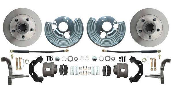

New Guy question: I'm building a 66 Coronet for the 1/4 mile drag and it currently has drum brakes at all for corners. I don't think I will need disk for the front right away but I hope to get the car up to speed that requires them eventually. So of course my question is what spindles will work or am I better off going aftermarket. The car wont see single digit 1/4 mile times, I don't have the money for that kind of speed. Thanks.
I know there are setups that you can use with stock spindles but this came up in a quick search. I'll look for the ones that use stock spindles.
https://www.sstubes.com/products/rd...cNPzK6mmU1ao3flilrKTaHcKu_PDxFqxoCEdwQAvD_BwE
Dr. Diff provided mine - ‘66 Belvedere. ‘Almost’ flawless install. Prepare to spend about a grand.
When these cars were new, I rode my 67 Satellite into the 10's with drum brakes and no problems. It's a controlled environment and usually great space to stop. Normal driving isn't a problem for properly operating and maintained drum brakes. I did install disk brakes on a car that I ran autocross and road courses with. Just another opinion.
Drums for drag racing. Switching to disc is a waste of money, especially if you foot brake. IMHO

Thanks. Your opinion is what I was looking for. I did the disc conversion. Probably just a mental thing but I’m glad I did.
Bad thing is I completely rebuilt the rear drums with Rockauto parts. Had to machine the drums and file high spots off the shoes - put some blue tape on the shoes to find the high spots. Never remember having to do all that in the past. Can’t find American made parts anymore. Thanks for responding.

Problem was, when bolting the wheels back on the rears would bind to the point that the car would not move, pushing by hand as the engine has not been finished. I’ve done enough brakes in my time to know when they are adjusted properly, and they were. The high spots were quite prevalent. A lot of filing had to be done. They seem to be okay now but I am certainly going to use you ‘seating’ method when I get the engine fired up. On the Dr. Diff discs, I had to chase all the threads on the spindles for the caliper mounting bracket bolts to thread in. Other than that they when together well.
