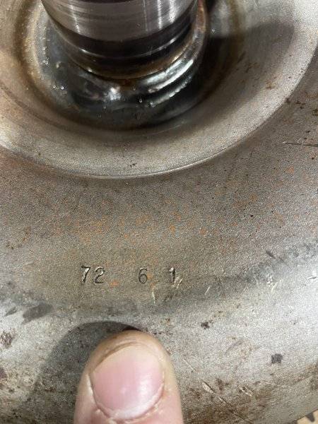

I recently acquired a 1966 426 Hemi Charger with original block, but was missing the tranny. Previous owner gave me a supposedly 727 hemi torque converter with the car. Since then I’ve picked up an original 1966 hemi 727 tranny that still had torque converter installed with flex plate.
Wondering if there are any identifiers I can look for to prove that the original converter I got with the car was an actual hemi or not.
The picture I attached is of the torque converter that came out of the 66 hemi 727 tranny that was not with the car.
Thanks in advance for the help.
A picture of space between starter ring gear would help. From top of teeth to convertor body is an 1" or so. If convertor body is out to edge 1/4" to base of teeth it's an 11" convertor.
The '66 High Stall Street Hemi torque converter is a one-year-only piece. In 1967, the input shaft diameter and spline count changed. There is much better selection of later converters. The early shafts can be changed out, along with oil pump and front drum for later stuff. '71 and up is best, with wider drum bushing.
I can get more pics. About 1” sounds right though. Thanks
