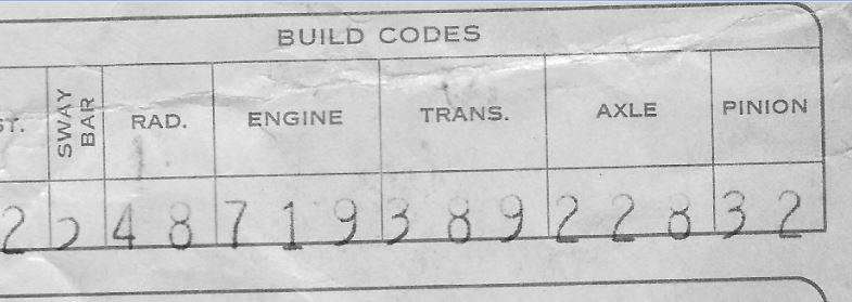

My 66 looks like 228 but could because it's an open no SG. I See Jerry answered.
