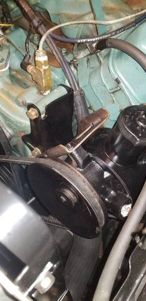

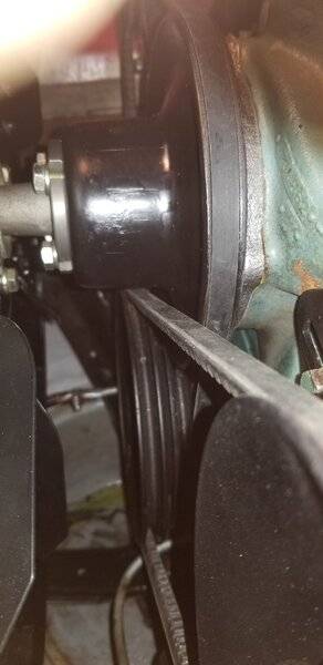

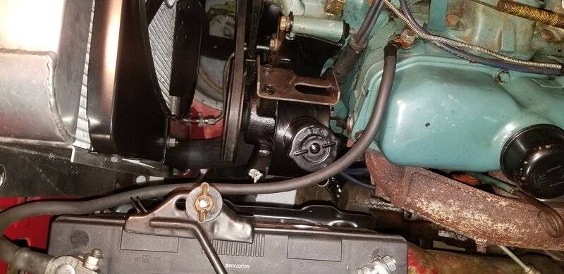

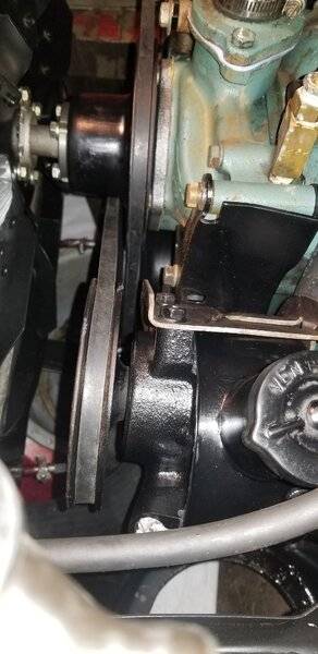

Does this ps pump bracket arrangement look correct for a 66 Satellite big block? Searched 66 Mopar dealer parts catalog and see 2 brackets for Federal ps pump. Parts catalog doesn't reference A, B or C bodies for the 2 different style brackets.

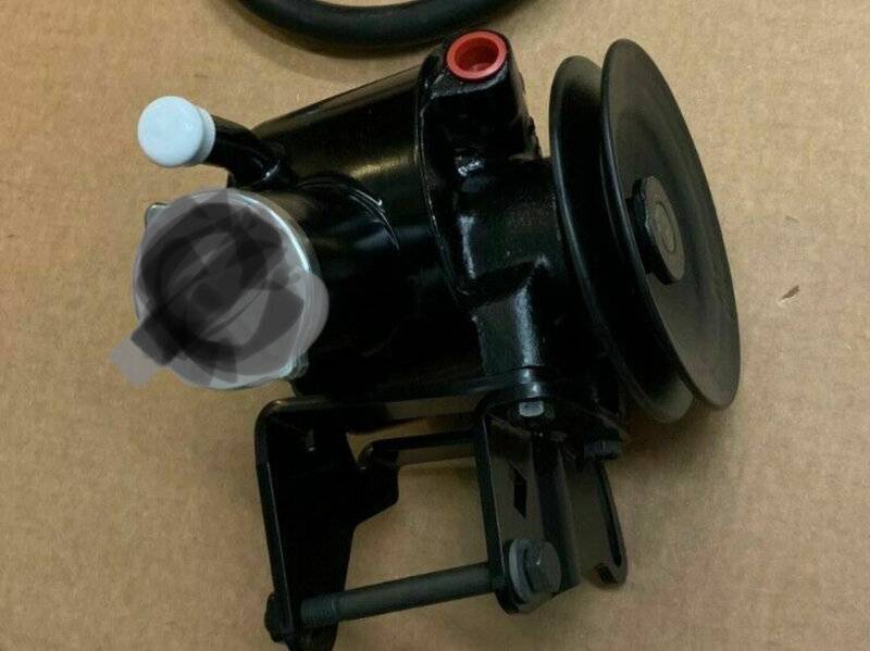

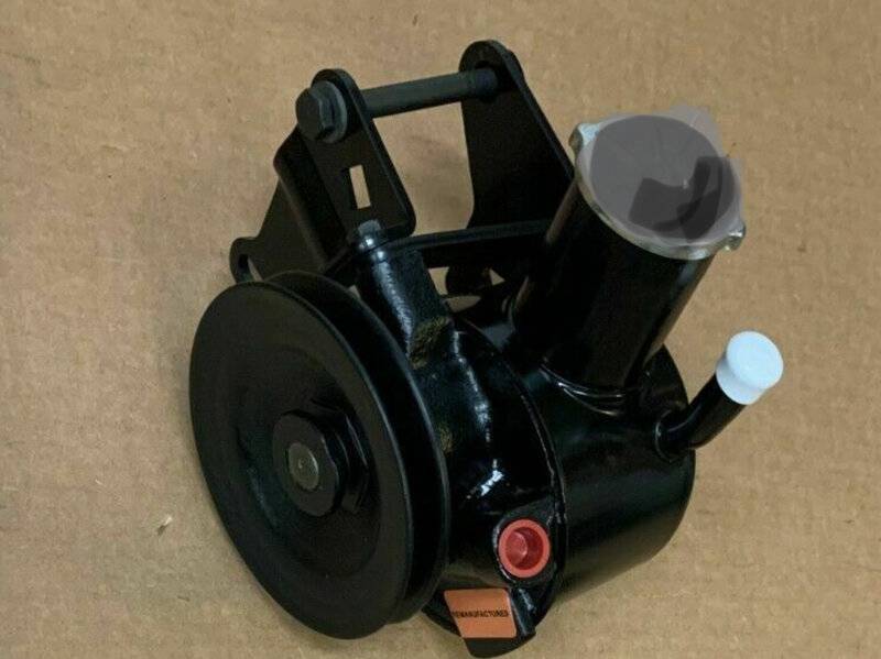

Good evening. That is a C-body only bracket. The pump is a TRW from a 413 or 440.
the pump pictured is what your car came with. Notice the pulley is smaller Thad the shaft the pulley is mounted to. I blotched out the gas cap they have on this pump to avoid any confusion.
051FEB1D-3C51-4E3A-8E70-D939E9B6C80C.jpeg 408A485D-465D-48A5-8718-A0C16CE65918.jpeg
The other style TRW pump bracket is repro'd. I had to buy one last year. I think I got it from Roseville Dodge in Detroit.
Interesting. I'm learning more and more on the mish mosh of parts on this car. Pulley I have measures 5 1/2" with its 5 1/8" reservoir can. Thanks for the info. I'll stick with this set up cause it works, but tensioning the belt is curious though.
