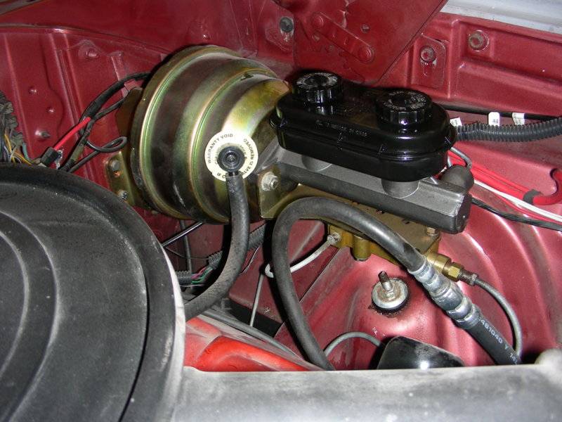

I changed out the drum for disc brakes on front and kept the drums on the back. Got a new master cylinder with booster and portion valve setup from Classic. I bench bled the clyinder several times and the lines several times and still don't have good brakes. When first pushing the pedal down I feel some braking but as the pedal goes down it looses power and have to push very hard to get any braking. The pedal also does not pump up to a solid feel with the engine off. The vacum is 12-15 lbs.

any pictures

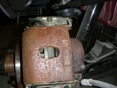

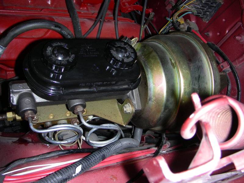

Here is pictures of setup and caliper. The rear brakes will start to grab and then releases as the pedal goes down. Did on gravel to find out which wheels were grabbing. There are no leaks. Put this on over a year ago so don't remember if I did or did not take off proportioning valve for sure. Would that be a place to try again?

Those calipers may be somewhat difficult to bleed too as the bleed screw is right near the inlet. Leaving a large area above all of that for air to be potentially trapped.

I believe the caliper orientation is your problem. There's no way to get the air out of the caliper. You can either swap sides or unbolt and tip upwards so the bleeder screw is the highest point. Put block of wood where the rotor would normally be and bleed them. Rear brakes likely are fine. I think your problem will be solved.
yep your calipers need to be switched left to right
Swapping those calipers side to side is a bad idea. That would put the fluid inlet above the bleeder screw.
These calipers are an older design and can work but in that configuration have been known to cause some bleeding issues. The one idea from @Don Frelier of removing it, putting a block of wood between the pads, orienting the bleeder screw to the highest point and bleeding is a good one.

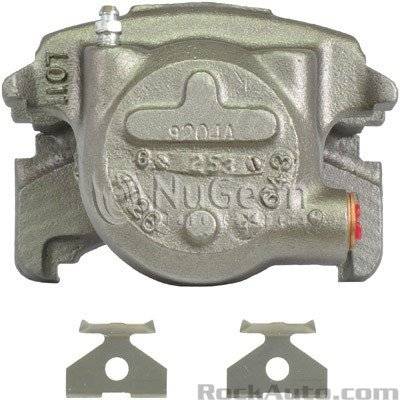

The earlier calipers had the inlet and bleed on the same side of the piston. In the future order ones from a mid eighties diplomat where the inlet and bleeder are opposed.
I’m still curious if you tried to bench bleed the master with the proportioning valve on?
This is an example of the diplomat caliper

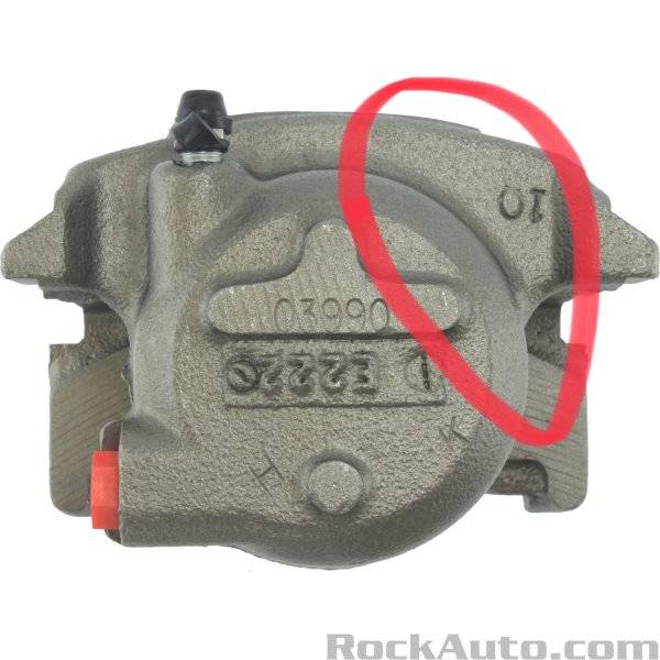

This is close to what you have (early 73-77 or so A body calipers), air could potentially get trapped in the red area I circled
No disrespect , but just switch sides on the calipers and you will be golden
You have a caliper problem. Either the wrong calipers or they are on the wrong side. Can't tell without more pictures. Hose routing looks wrong too. Very common problem, lots of people just assume that anything will bolt on to anything but it doesn't. They actually made different parts for different cars.
The calipers do not switch sides or the hose will be on the outside of the disk. I started from scratch and bled all of the system-bench bleed master cylinder, etc. Ended up that the calipers were holding air and had to take them off, tip them so the bleeder valve was above the inlet hose, got the air out and all is good. Thanks for all the ideas and thoughts about my problem. Now the car is ready to go to the body shop for a quarter panel, then back home to prime and make sure it is ready for the final paint.
