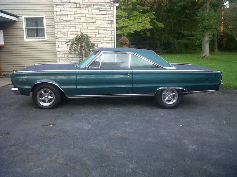

So i need new springs on my 66 satellite. I've been looking around for something that will give me the rake I want. I want the rear wheel opening to sit about 1" to 1 1/2" over the 15" rim. I going to try and post a pic of the car the way i want it. I'm using air shocks right now (the car came with them). I'm thinking super stock springs to get height right but what are people’s experiences with them and street driving.

Still not sure what to do and i cant drive the car till i get something. Problem is with ride height, The Tires are 275/60-15 and rub the inner well. on the 66-67 there is a slight protrusion up inside the well that rubs the side wall if the car is not jacked up enough like in the picture. I don't believe the XHD springs are going to go high enough. I'm scared if i buy the XHD spring and it's not enough I'll need to remove again and spend more money re-arching those. Is there an affordable option that has the ride height of the SS with the ride quality of the XHD? Any other company's beside MP?

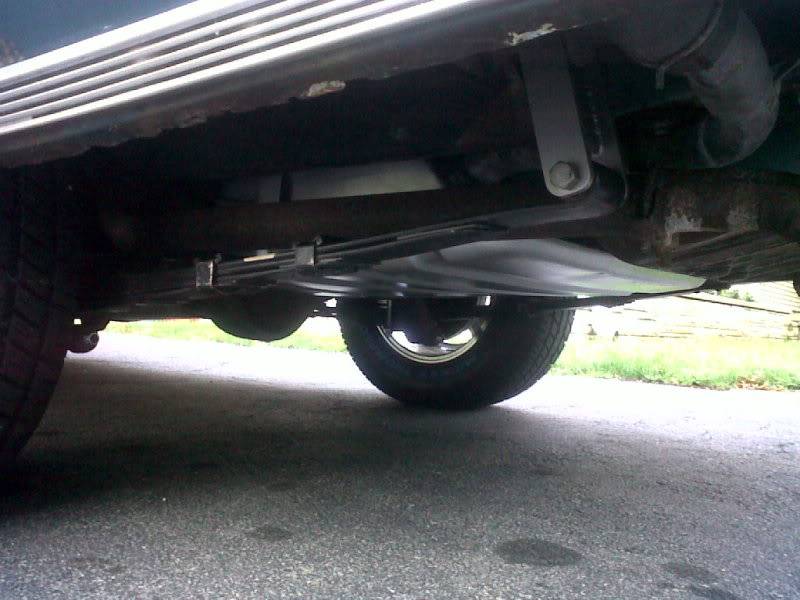

So I got the XHD spring and installed them last week I was supprized that they didnt do anything to raise the rear of the car not even a 1/4". you would think that 40 yr old set of springs would sag a lot and so I thoought for sure I would get an inch or so. So I made a set of +2.5" custom shackels that work pretty good. Not the exact height I was looking for but it's growing on me. Handles real good and drives great. I used a porta-power unit to open the inner wheel to accept the tires, looks good and no more rubbing. 275 60-15 mickey thompson on 15x8 with a 4.5 BS.

I put XHD's on my '67 BelvedereII, car didn't change in height either. I then bought a set of S/S springs for a 3600lb car, but got two of the heavier right side springs. Wonder if that messed up their inventory! The adaptors have two mounting locations; the upper one put the car at stock/XHD height and the lower one raised the car maybe 3/4". I wonder how the Silver Bullet was set up?
Actually I think I could just remove the shortest leaf on the left side and be back in "spec" but it doesn't seem to matter. My car has run 7.55 in the 1/8th mile, after next weekend I hope to see what it does in the 1/4. Car launches straight, on the street of course it bounces over imperfections in the road. It's got the MP extended length shocks in the rear, stock 318 bars up front and decent life left in the normal replacement style front shocks.
I thought of longer shackles to gain some height, still might try them some time just to see what they do--as long as you don't go "over center" with the shackle's angle it should be okay, but I've never seen them recommended for racing.
