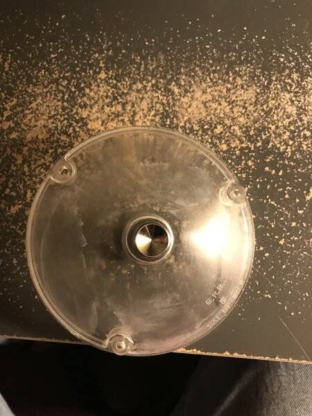

Had turn signal lenses off car, and one had spots of black spray paint dotted on it. Sprayed with carb cleaner, please don't crucify me, and while it took the spots off, it left the lens milky looking.
Anyway, I also tried WD-40, soap and water, and window cleaner. Frosty look still there. Two questions: is the lense salvageable cleaning with something else, and would a razor blade been more effective?

Sand it with some 600 then polish it....if it isn't brittle. Should come out pretty good.

Once fogged up odds are against you can polish them out. But its definitly worth a try
You can get a paint polishing kit for models ate Hobby Lobby.
it has grits from about 3000 to maybe 12000 or so.
start with the lowest and work your way to the top. then hit them with a plastic polishing compound.

WOW, while most manufacturers have those listed in the $55 each range, I did find a source for 45 on eBay. This blows me away for only $35. I tried using the 600 grit sandpaper on the lens and thought it worked well, but once it was dry, the frosty look reappeared. I may just order the pair and keep "Frosty" as a spare!

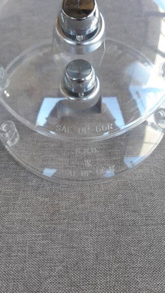

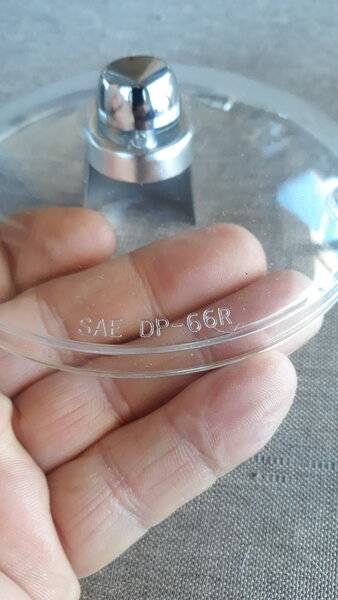

Mine came in. And they look killer.

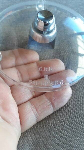

Only difference i can see is the lettering on the lower face of the lens
My nos one have GRB .
Then the DCPD insigina above the SAE DP -66R
The repos just have the sae and related lettering.
