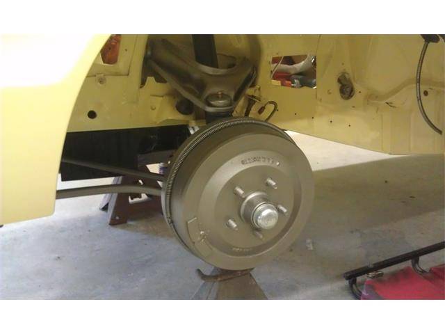

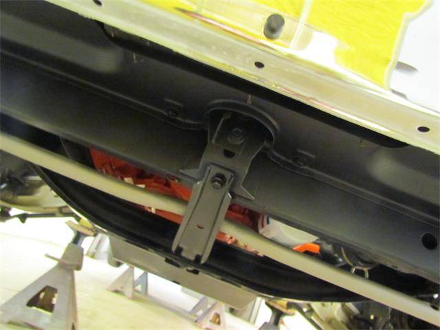

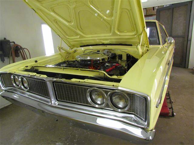

If you look at this restoration you can see some black spay paint on the radiator support. That was mainly done so the light color of the car didn't show through the grill. The rest of the underside and fenderwells were color on this particular build.

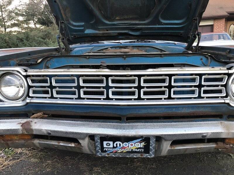

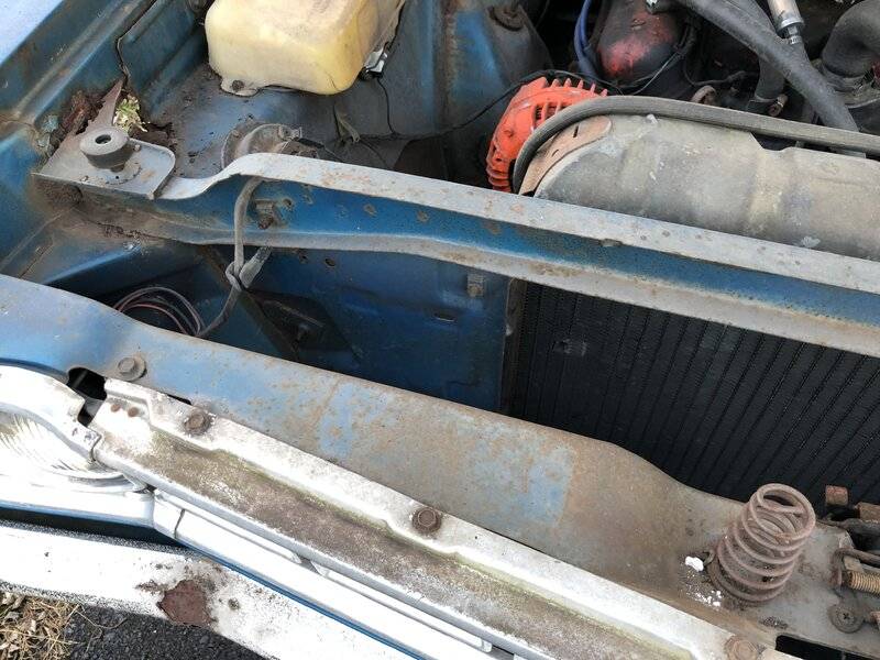

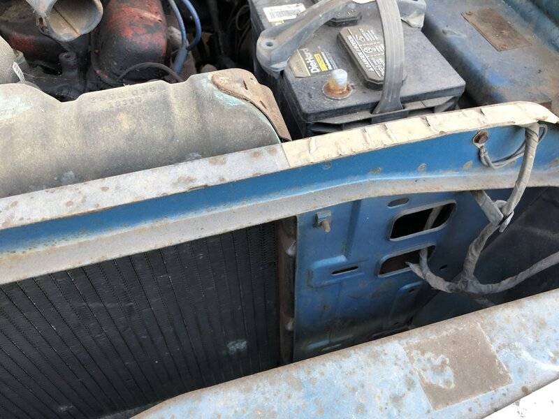

Car Craft magazine restored a B5 blue ‘69 Dart Swinger back in the 90’s. Richard Eherenberg said it was “incorrect” because they didn’t paint the rad support semi flat black. It was noticeable looking at the front of the car. He explained that all Mopars other than Black and dark blue had it. My ‘68 Satellite wagon is still in factory QQ1 Electric Blue paint, and as you can see the guy in the pit must have run out of paint as it went by. Just two squirts is all it got. They didn’t all get the black paint!:D
Sure. I live in Oklahoma. Sunny and 65 F.
Car Craft magazine restored a B5 blue ‘69 Dart Swinger back in the 90’s. Richard Eherenberg said it was “incorrect” because they didn’t paint the rad support semi flat black. It was noticeable looking at the front of the car. He explained that all Mopars other than Black and dark blue had it. My ‘68 Satellite wagon is still in factory QQ1 Electric Blue paint, and as you can see the guy in the pit must have run out of paint as it went by. Just two squirts is all it got. They didn’t all get the black paint!:DView attachment 1207811View attachment 1207812 View attachment 1207813

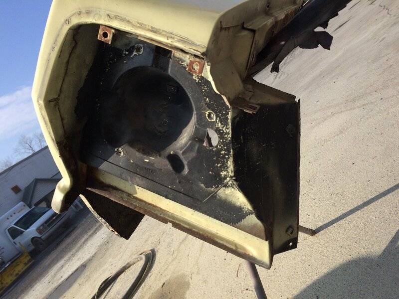

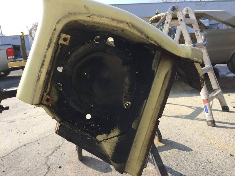

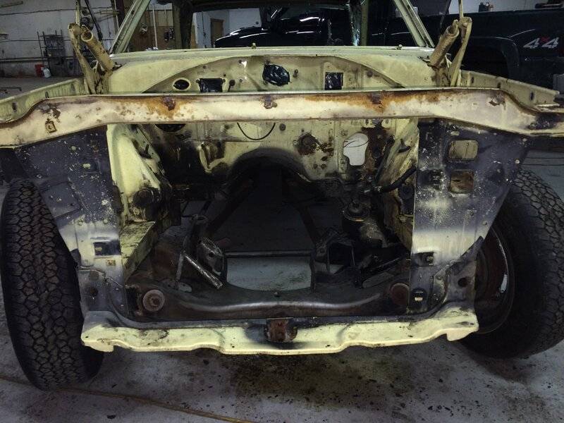

I think these will help. Mine during deconstruction from original.
