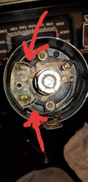

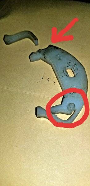

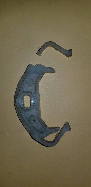

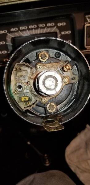

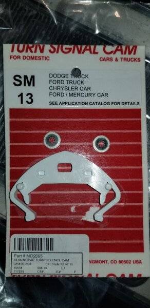

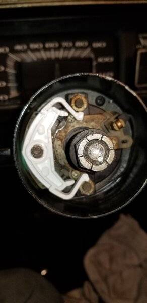

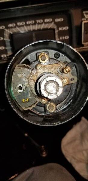

Well funny you should ask. Just replaced my cancelling cam yesterday on my 66 Satellite. The old one was broke at the right turn cancelling tip. This one I purchased from Classic Industries $10. New part was a near perfect replacement. I put a dab of di-electric grease at top and bottom detents where cam nubs ride the switch housing lobes. Firmed up the turn signal lever action. 20220331_171628.jpg

A tab on mine was broke so one side wouldn't cancel. The replacement cam made for firm action.
I had the soft action, but figured it was due to the broken nub on back side of cam piece.
That circled nub (as I call it) rides on the lobes at each end of contact housing. That's what firms up the lever action.
I couldn’t see anything broken on mine and I do still feel the detent action but it’s very soft. For the money I may try a new cam and see what happens.
