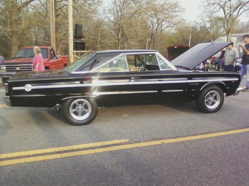

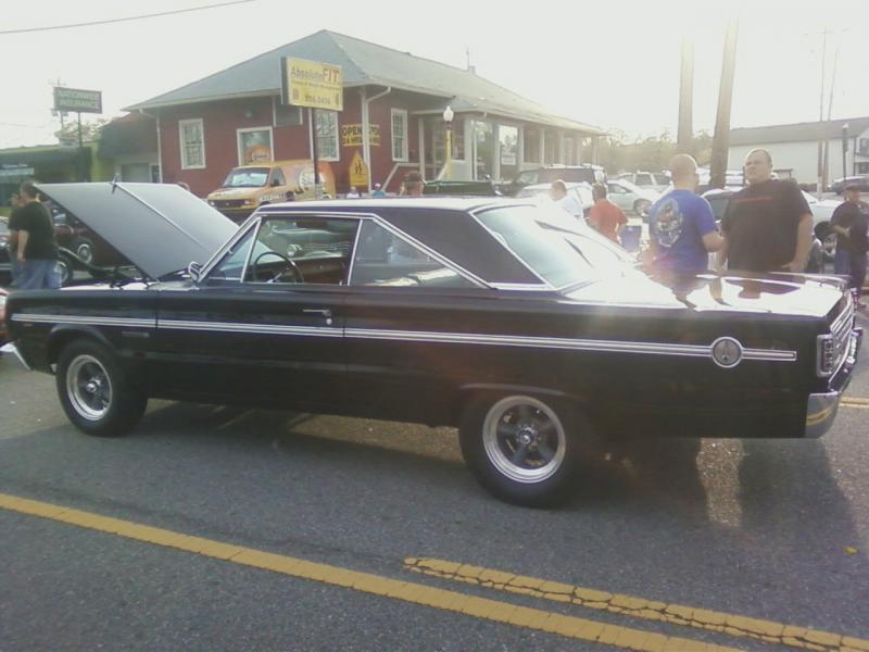

I raised my 66 2 inches by having the factory springs re-arched and adding one leaf. The car drives very nice out of the highway and hooks up good to.
It cost $175 to have the springs done.
That's a great stance.
I've always thought somewhere beween the rim and the letters on the tire-right at the bottom of the rear wheel opening looked the best on 66/67s.
Gives you enough room to turn the front wheels or run 15s in the front.
