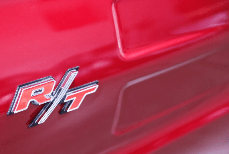

What are the differences between 66 and 67 Coronet quarters? Is it just the two indentations? If that's all, is it possible to cut that area out of otherwise rusty 67s and weld them into a pair of solid 66 donors? Anybody ever try it, or is that just insane / destined to look like crap? Trying to think outside the box a little to fix my rusty 67 R/T convertible without breaking the bank.

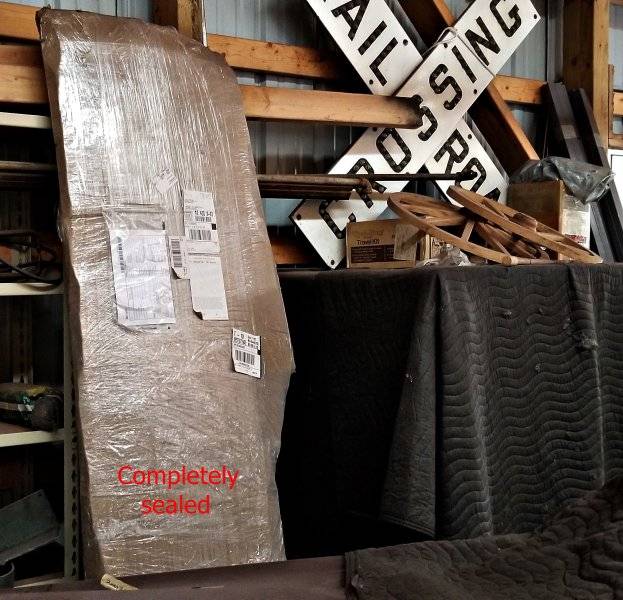

Those aren’t full 1/4s so they would actually have a longer seam to weld and finish than welding in the vent area to a full 66 1/4
They are 8+ feet length and as full as I can see......... not sure where you are coming from?
unless you are including the top lip to the window as being full and bottom lip towards the front.
No one makes this panel or over the rear well other than Joe.... who is making a similar panel for me now.,.
Yes I have seen ones that are mass produced...... that is why I choose Joe's product.
18 gauge
