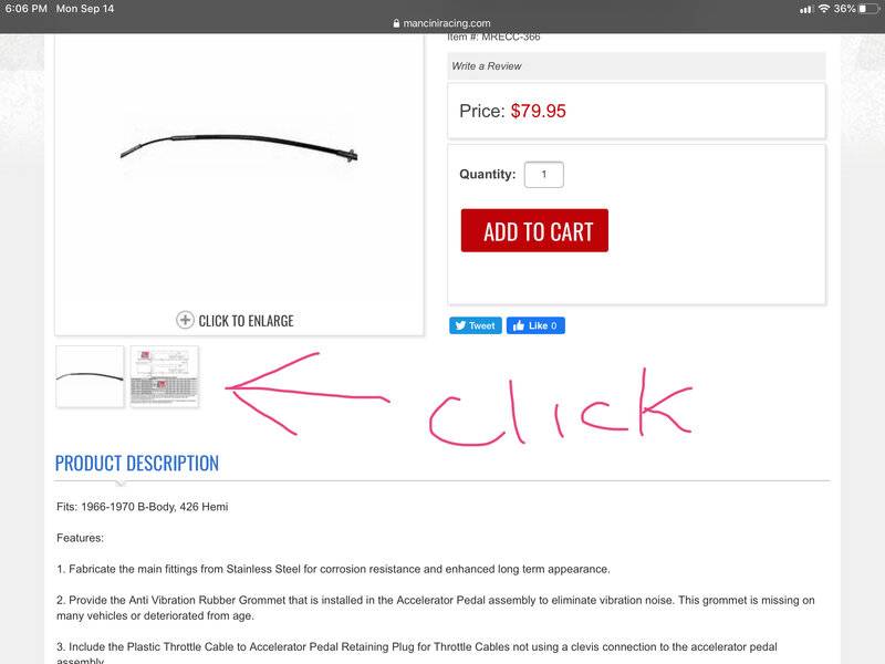

here is a measurement chart, click the chart.
https://www.manciniracing.com/marathca.html
