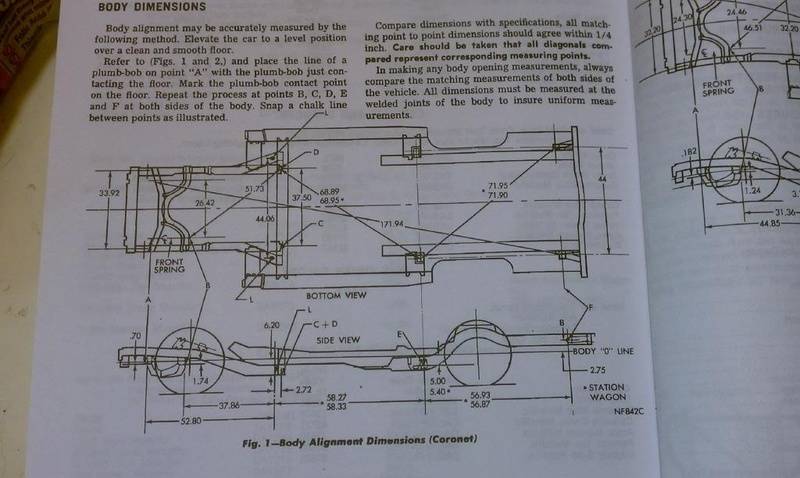

ok so the 67 Dodge and Plymouth b body's have a 1 inch diffrence in wheel base lenyht. so where is this one inch difference ? floor? rear springs?
Fran posted this awhile back...
