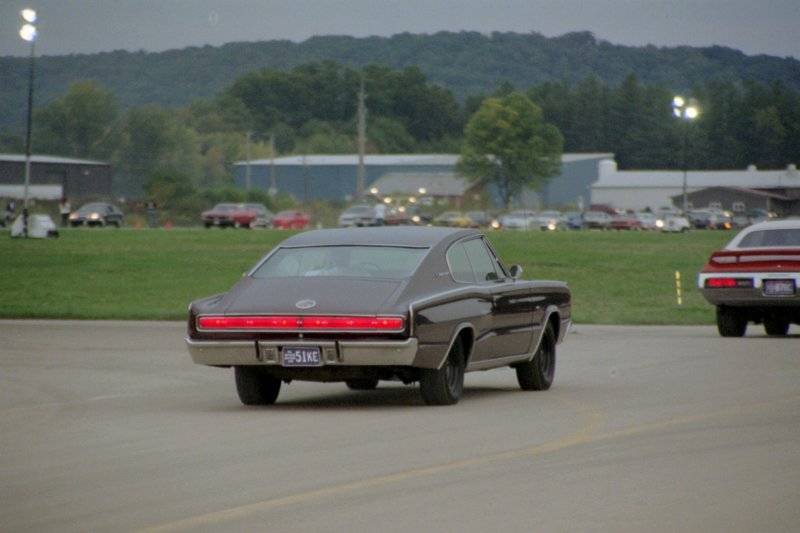

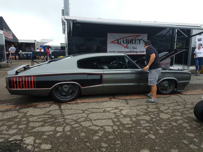

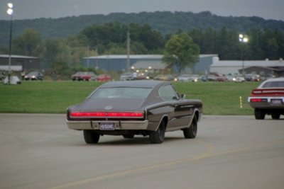

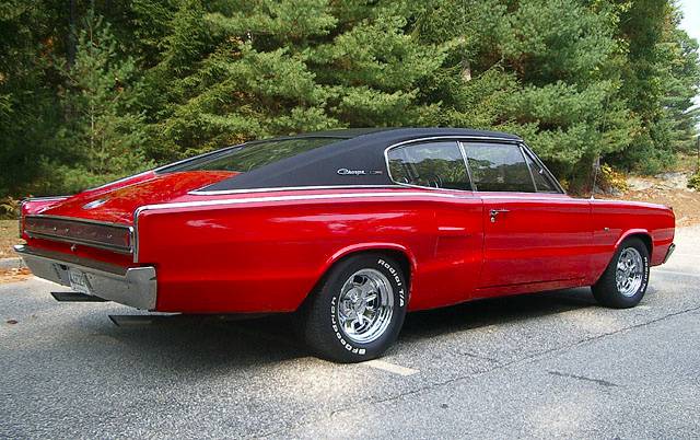

I saw this at the Nats and fell in love! I know, I know, not everybodies cup of tea but I likey.

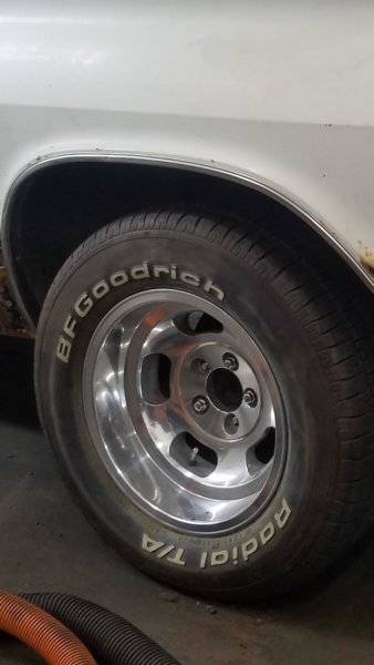

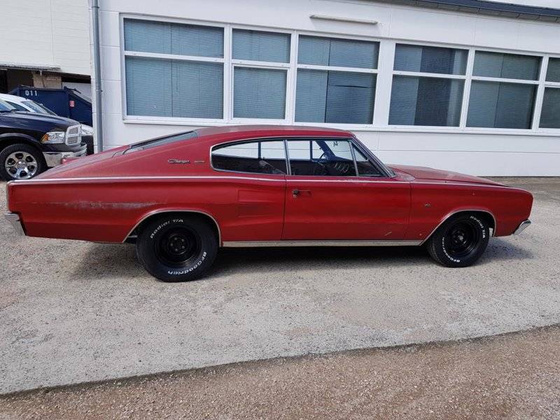

Thanks for your responses. The previous owner put on rear leaf springs part number (p3690460). This is what the stance looks like. WAY TO HIGH!

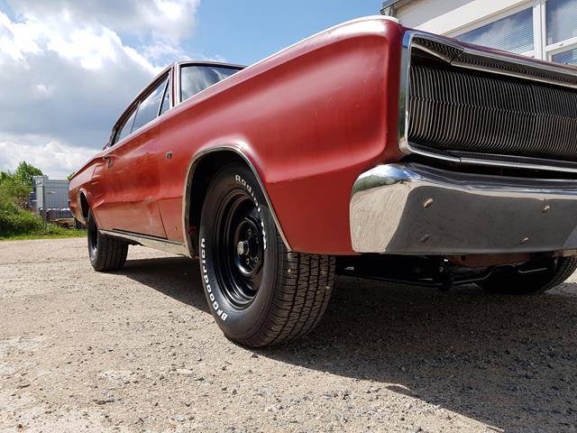

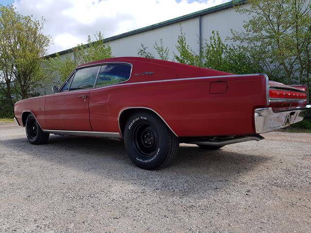

Front 225/70-15 on 6x15 O.E Wheels, rear 255/70-15 on 7x15 O.E. Wheels. Sorry, not polished.
We need to see the hole car and pictures of the shackle arrangement.
If they put extra long shackles on the rear, then you can just change those.
How are the torsion bars adjusted?
The shackles are stock.

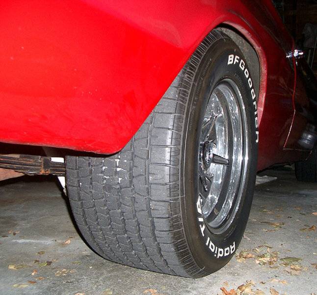

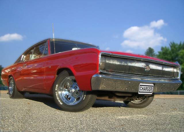

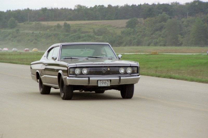

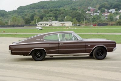

Leaf springs are ESPO XHD 1" higher and the rear axle is set 1/2" to the rear (3,5" Danny's aluminum drive shaft with 1350 yokes) because of the wheel clearance
Torsion bars are FFI 1,06"
The height in front are ~ 1/2" lower at the measuring points (LCA)
Because of the car's shape, length and overhang past the rear tires, I was never fond of having the back end up at all. But to each his own.
