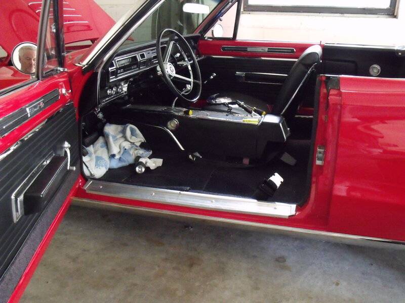

Hello to all....
My 67 Instrument panel screws are all missing that hold the instrument cluster to the dash frame top and bottom
My instrument cluster was just sitting in place with no screws holding it in place when i bought the car.
Would someone please show me a picture and its thread size and length please?
They maybe exclusively for the dash or just a common hardware store variety screw.
Thank you in advance... Mike
