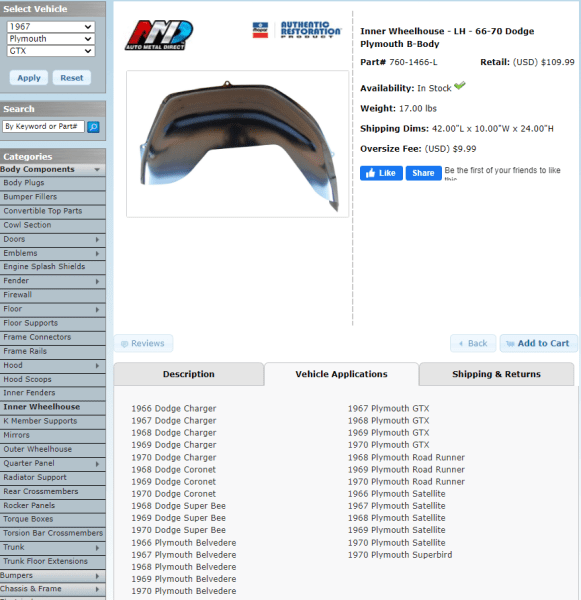

Thank you for the info. Being a Roadrunner guy up till now, it really helps. The thing that threw me about AMD inner wheel house is if you set your vehicle as 67 Coronet it doesn't show up in available parts. Also, it isn't listed in vehicle applications, even though 67 Charger and 67 GTX are. To make it more confusing, other websites sell the same AMD inner wheelhouse as correct for the 67 Coronet.
Look at the photo of inner panel you are displaying above...
check it out before you buy it.
my 2 cents worth.
Look at the photo of inner panel you are displaying above... it does not show it fully as it should.
its missing the part where it meets the outer skin panel at the wheel opening...
you may have to fill it in yourself.... check it out before you buy it.
my 2 cents worth.
The outer wheelhouse meets the quarter panel, not the inner.
