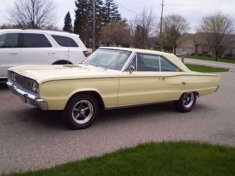

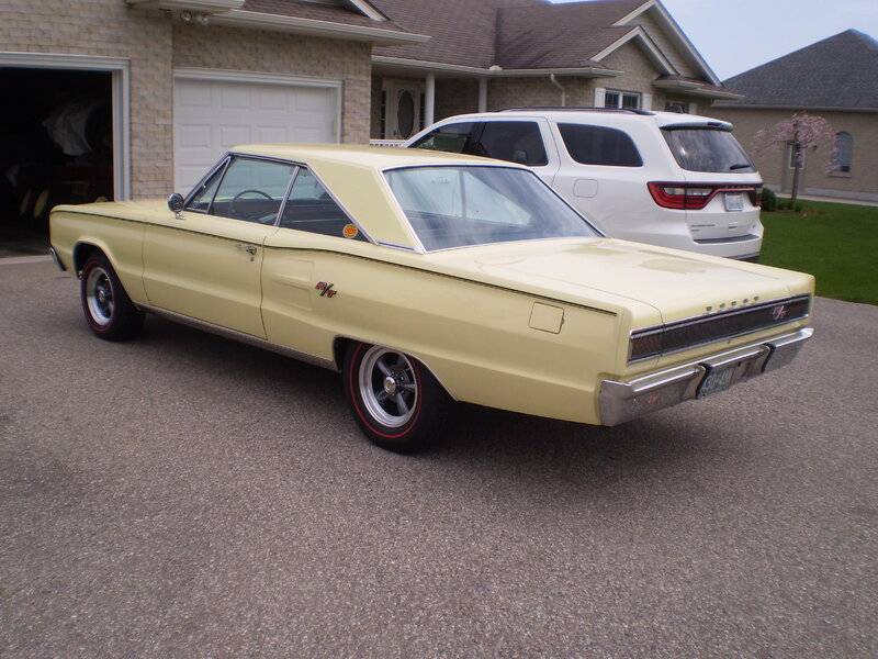

I used to run 225R70 BFG T/A's on 15X7 cop wheels on the front of my '67 R/T and found that they scrubbed on rear inner fender well on full turn. I now have 215R70 on 15x7 Jeg's wheels, and they clear fine. I am not sure of respective back spacing, as that might be a factor. I run 235X70 on the rear with no clearance problems. I have added rear sway bar, which keeps rear end more settled.

Do you know what the BS is on the Jegs wheels?
Do you know what BS the wheels are? I am trying to make sure if I get 225's they wont rub. Once they are mounted on the wheel it's to late to swap out for another size.
These are the 15x7 US Mags Slots. They’re new. Summit shows BS at 3.75”.
