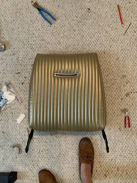

In true bone headed fashion, I took a lot of pics of my old seats, and filed to measure exactly the seat medallion locations on my buckets and rear bench. All I need is the measurement from the top of the seat to the medallion top.
Also....installing these will require them to be added through the foam on the buckets and just through the seats material on the bench.

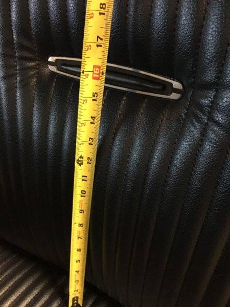

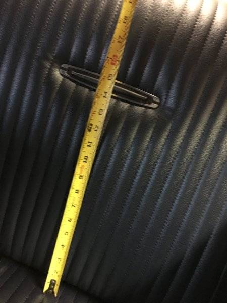

71RRHI posted on this in 2018 in the 1966 1967 Mopars section. There are measurements listed.
You go through the foam on both front and rear. I can get a measurement in a little while.
Approximately between 6 and 6.5 inches from top of the seat.

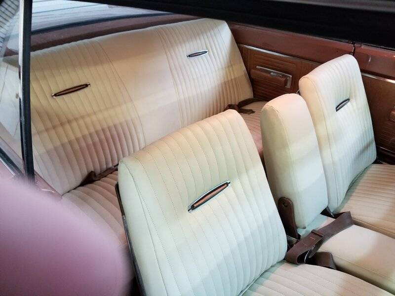

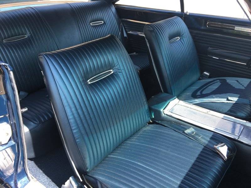

In the picture the fronts were pulled in, the back seats weren’t. I am thinking of pulling the ones in the back seats slightly, just in case at sometime someone wearing a bra might sit there. When new there were complaints from R/T and Charger owners about this.
I took the medallions off an original rear seat about 2 months ago and it was attached just like the fronts. It was through the material and foam, and pulled in slightly. Not as much as the fronts but was pulled in.
