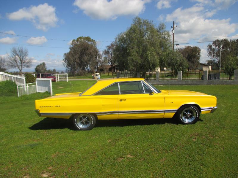

I have a 67 Coronet 500 with a 383 AT. It has an Edelbrock intake, Edelbrock performer carb (Carter AFB style carb). All of the fuel lines have been changed from the tank on up including filler tube rubbers and tank seals etc. Has new fuel tank and sending unit. The car will not start in the morning without priming the carb. Sometimes it will start but I have to pump the gas about 100 times to get it to start. After it fires up it will start the rest of the day as long as it doesn't sit more than a couple of hours. Any ideas? One other problem, I replaced the fuel sending unit because it would only read about half full after a fill up. The new one does the same thing. The first full tank it went to full after the fill up and then went to half after a 5 mile drive or so. My car doesn't get the best gas mileage but I know I didn't use half a tank in 5 miles LOL! Any help would be appreciated.

Great looking 67........

Yep, great looking 67 !

Nice Coronet
