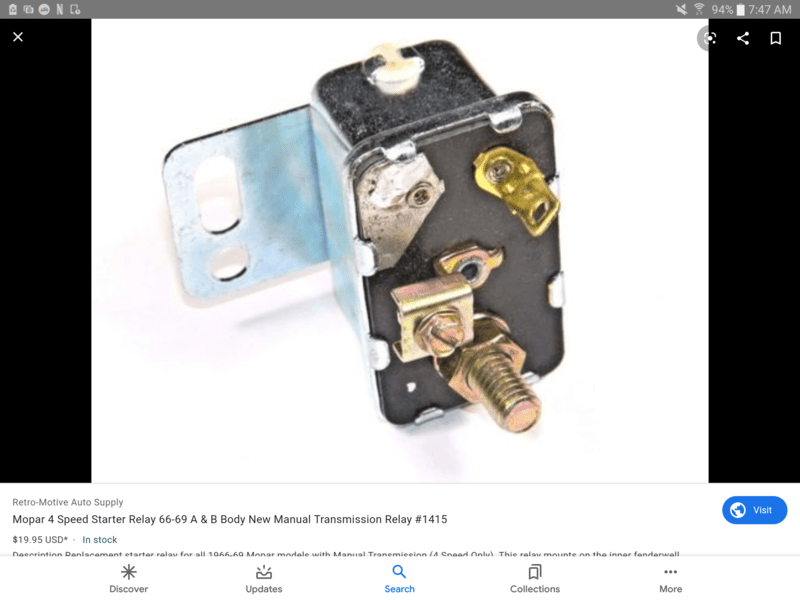

2. Starter relay. It has a ground prong for an automatic neutral safety switch. What do you do with that when you are running a 4 speed. If all else fails, I'll run it straight to ground, but what did the factory do with that post for 4 speed cars?

#2 you will ground it. you can either install a short jumper from the relay bolt or solder the pin top the relay case like the factory did.
