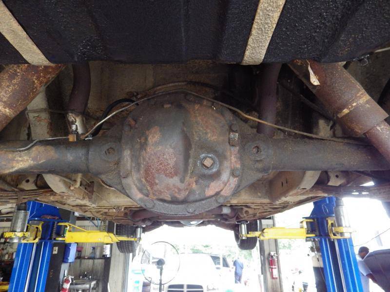

So now you guys really got me curious, if the rear end is factory and its a Dana, a 440 four speed for sure, so, an 8 3/4 would be 383, and 318 would prolly have a 7 1/4....is that right?
If the car is in salvageable condition then I'm sure someone over on FCBO will buy it, if it's rough then the pedal assembly, Z-bar, frame bracket and floor tunnel are worth good coin!
It is a Dana 53
I remember it having a small pinion similar to the 741 8.75
Dana 53 is a truck rear end
