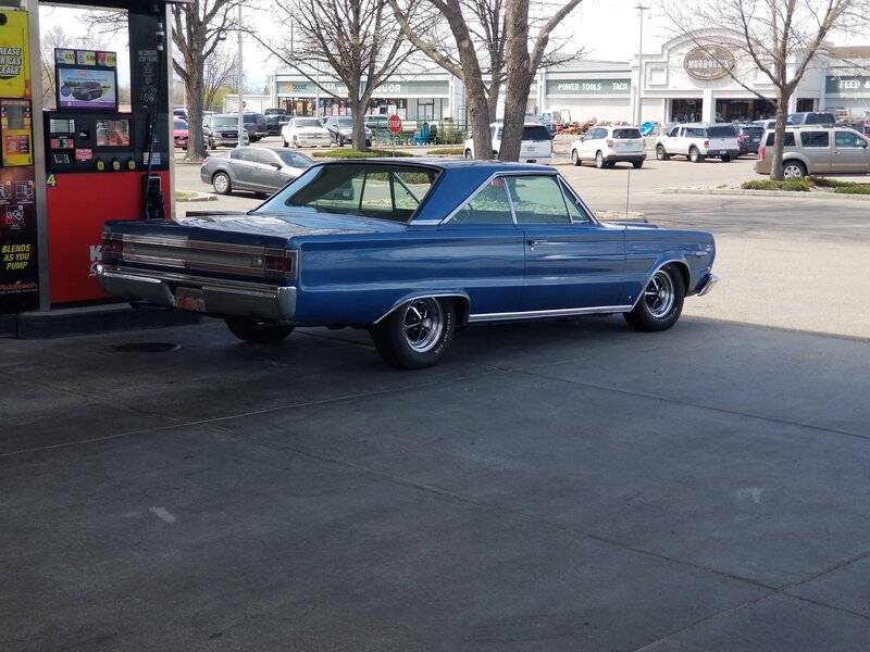

Wanted to know what you guys thought were worthwhile upgrades for my 440. I drive the car everyday, have a rear main leak and am going to paint the motor. I figure it's probably a good time to rebuild as it will be out of the car. Definitely changing the camshaft to wake it up and get a more respectable sound. Problem is I don't really want to change the 915 heads because I want to keep the car period correct. Is it worth a stroking or putting headers on if leaving these heads? What is the potential of these heads and who knows Mopars and 915 heads well enough to make it worthwhile to port them? I know it's cost prohibitive, but I really love this car and I think keeping it more factory looking is more important than the bang for the buck I could get with aluminum heads. Open to running headers if it's worth it while keeping the heads. I run a Holley Sniper, Torqueflite, 3.23 Gears, and will probably look for a torque converter with a 2600-2800rpm stall. I drive 15-20 miles per day in town and hwy on weekdays, around 100 hwy miles on the weekends when the weather is nice. Would love to change gears, but I'm already running 3200rpm at 70mph. Thank you for your time.

R413- I said I was trying to avoid aluminum heads, headers are period correct, and you can't see the fuel injection or a stroker crank. Or at least I can't. I'd like to avoid headers just because of the possible leaks, but if they are more of a bottle neck than the heads, I would probably run em.
Cranky- Good point that I probably would have to raise the front end. I installed larger diameter torsion bars and it rides pretty well where it is, and I like the look with the roof parallel to the ground so I'd like to keep it there.
Jerry Hall- I guess my question was more along the lines of what is the limiting factor, heads or stock exhaust manifolds, and if it's the heads does anyone know a reputable shop to modify them. If I install larger valves and pocket port, would the stock manifolds likely be insufficient or still adequate. I'm sure someone who's spent some time modifying this particular combo knows the answer. Just trying to do the right things without wasting money, I have enough projects to get rid of all my cash.

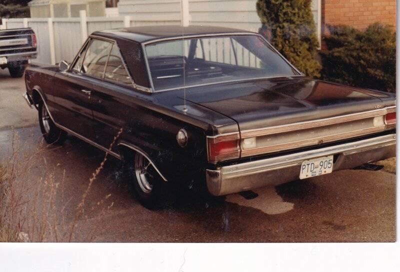

I built this GTX years ago with ported 915's, 3.23 gear and a solid lifter camshaft. It was very tractable and ran in the 12's fairly easily. The 67's weigh about 3700 lbs so it's not that hard to make them run hard.
