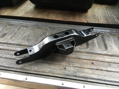

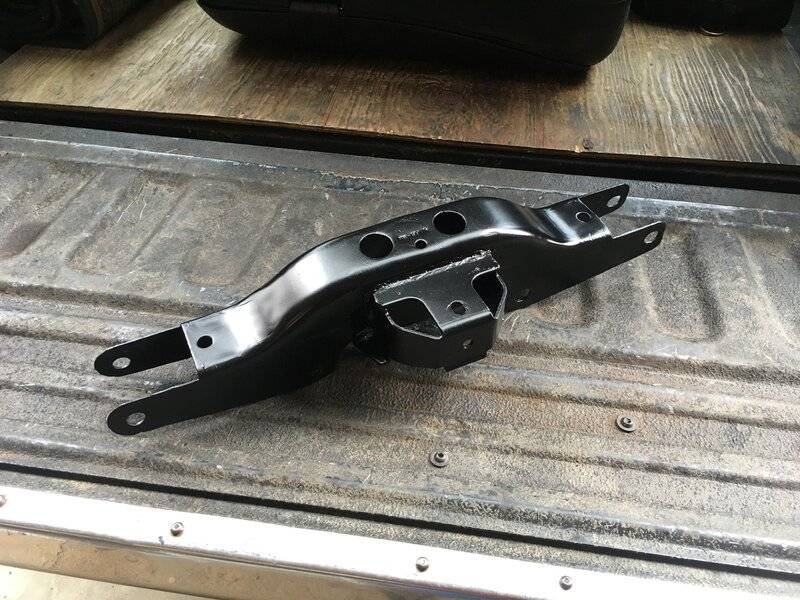

Question: How does the 727 trans mount to the transmission crossmember on my 67 GTX? Is there something similar to a motor mount between the trans and the crossmember Is it one bolt or 2? Are spacers used or not?
There is a rubber mount that attaches with studs and nuts. The mount is molded with 2 studs which attach to the transmission and 2 which attach to the mount with nuts and lock washers.

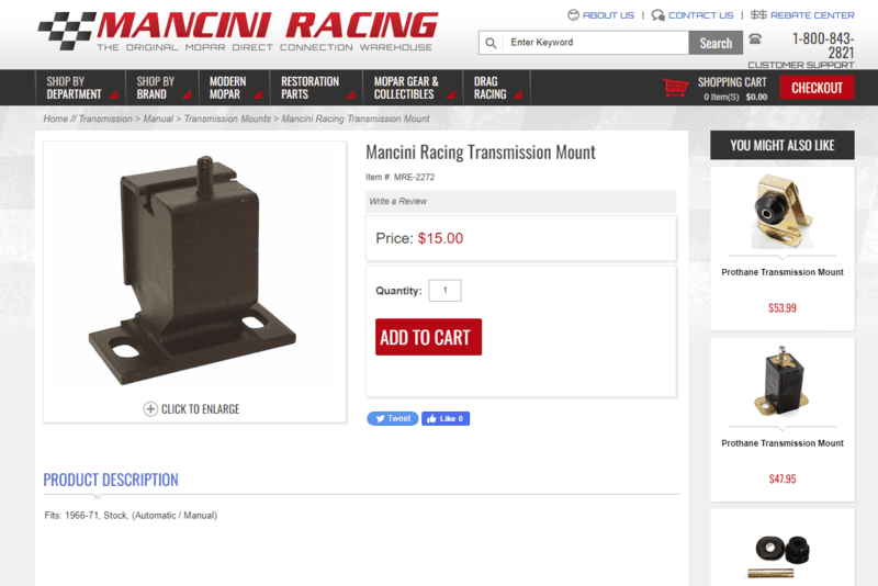

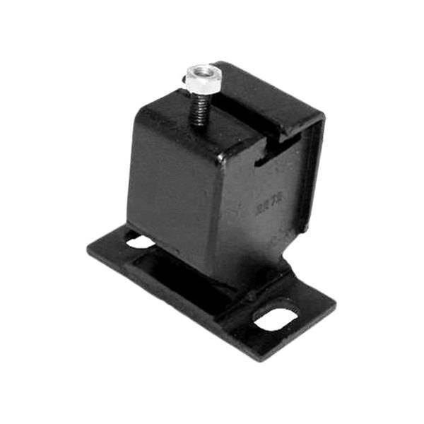

The mount shown above is the mount I need for my 68, but everywhere I look I only find this one...
Are there 2 types and where can I find the one in zyzzyx's post?

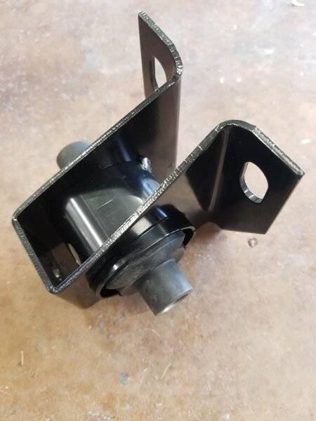

For a street application the poly mount may not be desirable. Check if there is a difference between 4 spd & auto. I forget. Lots of suppliers out there.
Anchor 2272. Should be under $10 from somewhere like RockAuto.
