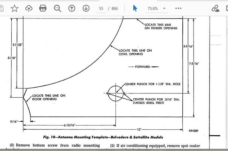

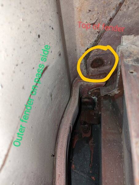

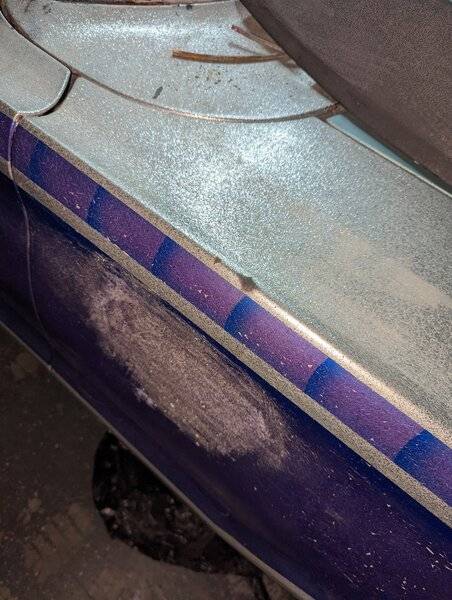

I am in the process of prepping my car for media blasting. Car was a race car for a while in the 80s. They plugged the antenna hole.
I am looking for the measurement off the top of the fender to make sure I get it in the right spot.
Underside of fender has what looks to be a hole and where they welded it up. But am hoping someone can help verify.
On the pic of the inside I wrote what part is what to help with orientation.
Any help would be appreciated.

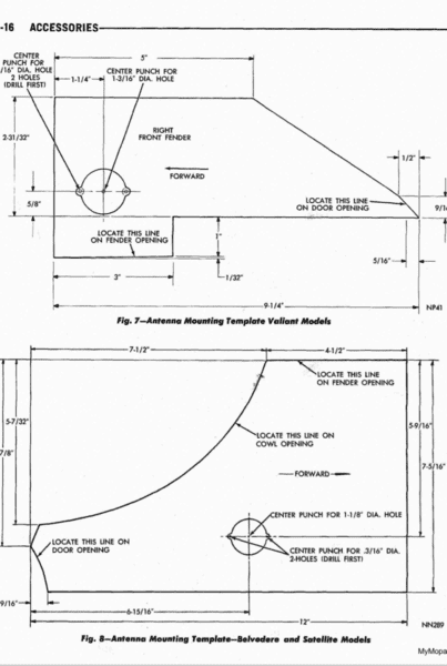

For the next person. Attached is the page out of the 67 service manual

There should be a brace where the whole goes. As for the the ones that had them on the quarters my dad had told me that a friend of his bought a 67 GTX new when my dad bought his & it had the antenna on the rt quarter. My had bought one from a friends brother a few years back & it also had the antenna on the quarter & when we took the rt fender off there was no brace & no factory whole.

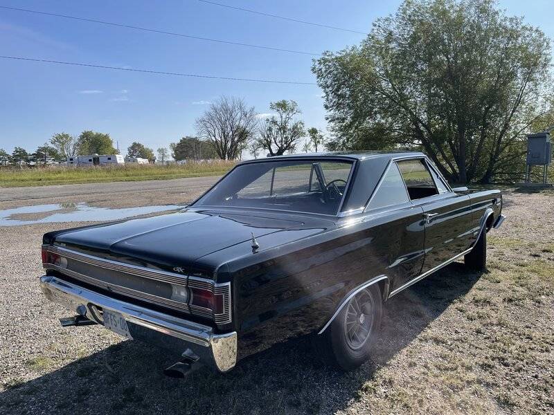

Left quarter on red/white. My car red/black, look carefully you can see base on right quarter the is hard to see. Black one on front fender
