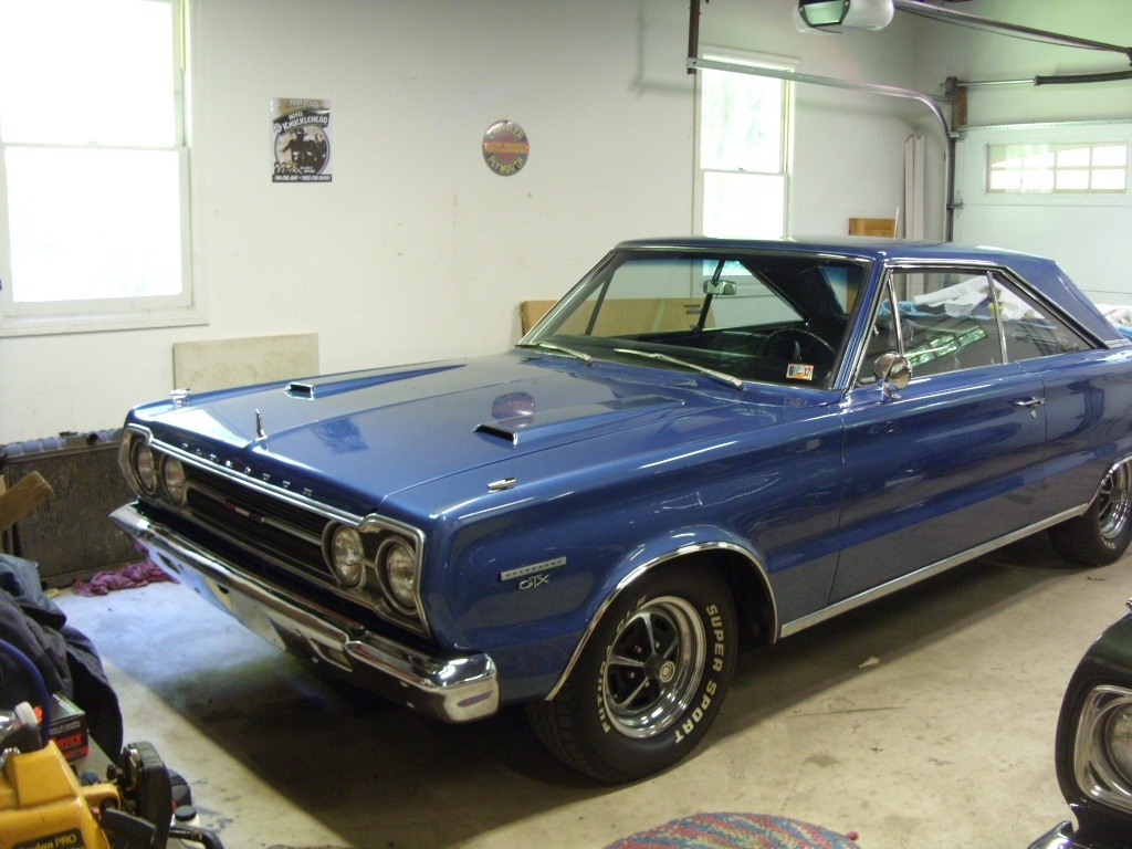

Hi, my name is wayne. My dad is xman. We are restoring his 67 gtx 440 4spd. He bought the car about 10 years ago. Just so happens it is the car he bought new in 67. We are painting the engine & brackets. Does anyone know what gets engine color, black & stays bare metal ? My doesn't remember. Back in 67 it was just a new car & my dad didn't pay that much attention to the details like that. Or does anyone know of a site I can get on to. Thanks

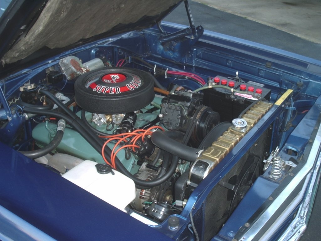

I don't know the code but it was a light turquoise....best I can do unless I research
the block and intake are turquoise....
Yea we got the right color & just got the engine painted. Not sure what gets what colors
I have the information needed but not been able to excess since computer crash...
the alternator & power steering brackets are black... The engine wirer Looms were Black with engine over spray ..turquoise paint
The original temperature sending unit is not painted
motor mount brackets and insulators are painted black, not engine color.

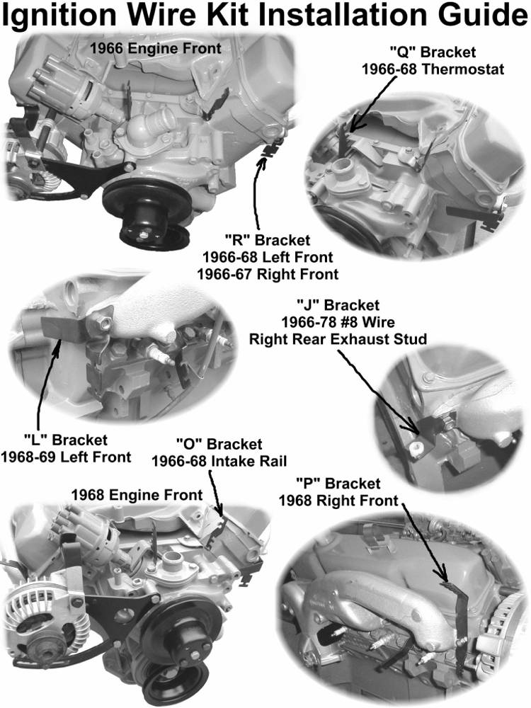

good site for information...
International Chrysler Collector Authority ICCA ©
1968-advertisment-jpg.66446
The
Wire_Kit_Guide_1.htm
Wayne and dad, Mopar colors are my life lol but real research and documentation are pretty scant.

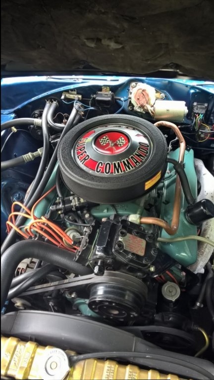

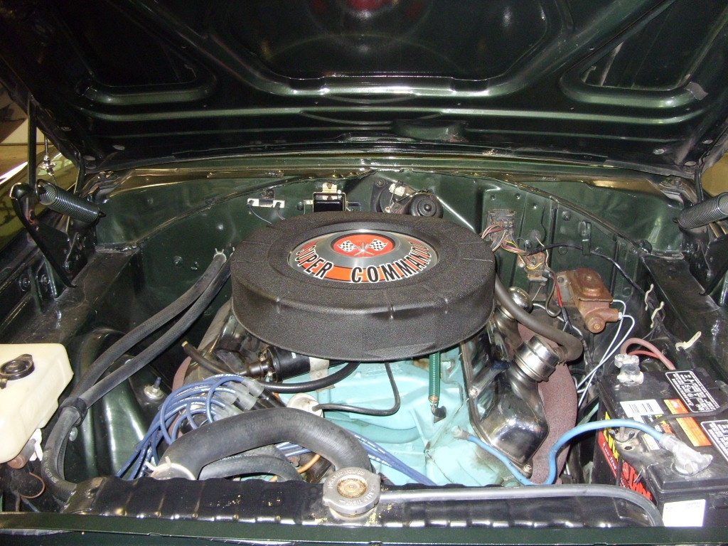

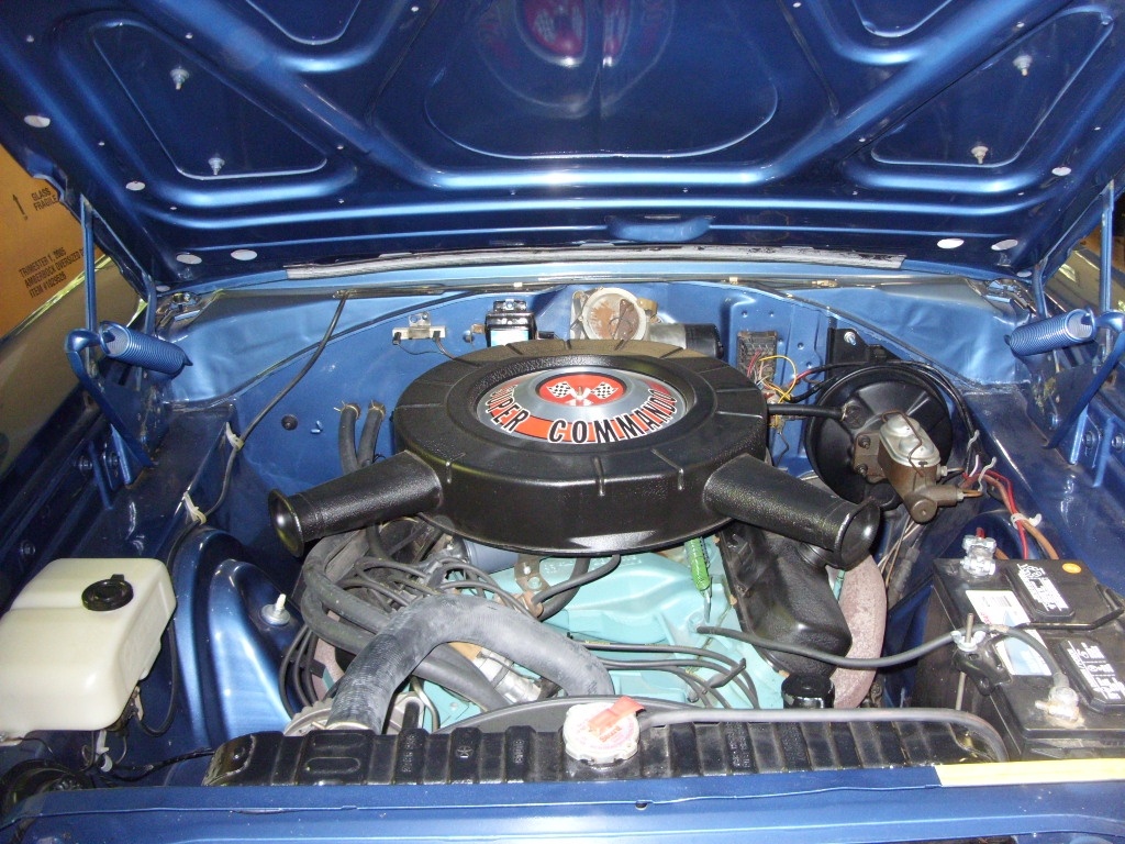

Kudos on going back to original! Here is my 1968 in mostly original colors. I think the 1968s and 1967s were the same except for the air cleaner type. The spark plug wires should be black, as should the radiator and the copper AC line. Other than that, I believe that I got pretty close to original colors.

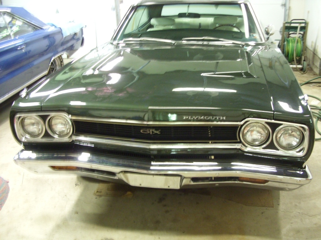

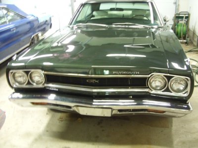

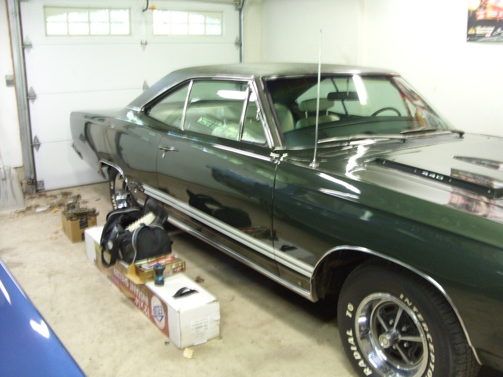

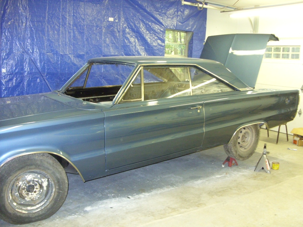

My dad is the XMAN I do all the computer work lol He knows nothing about computers & im close behind. Here is some pictures of my dads other GTXs. He has 2 67s & 1 68. All are 440s & 2 of them are 4spds. The 68 GTX he has owned since 1972 & has 53,000 original miles.
dads gtxs 001.JPG dads gtxs 006.JPG dads gtxs 002.JPG dads gtxs 003.JPG dads gtxs 004.JPG dads gtxs 005.JPG
Wayne, does the 68 have the original engine? And my Dad alwaus told the story you left that car outside one time and it started to Hail lol.
No, its a 68 but not a HP block. He does have 68 HP 440 for it. Not to long after it was painted, we pushed it out to wash it. My dad ran down town while I dried it off & a freak hail storm popped up. I didn't have enough *** to push it in by my self lol All I could do was watch.

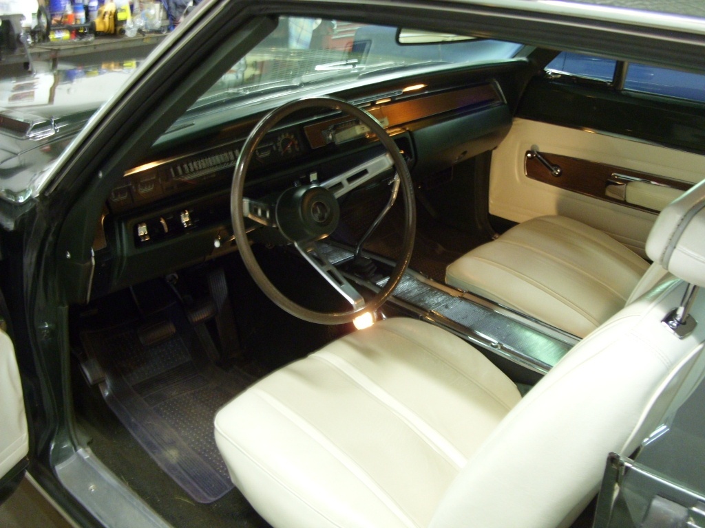

I have 67 Gtx 4 speed car with MM1 external paint, white buckets with console. Black lacquer pain on doors with white vinyl scroll door inserts,black carpet. What color is the headliner ( white or black). Are there codes? Visors are white b

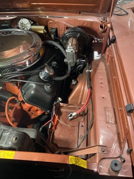

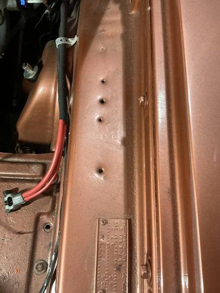

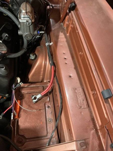

This GTX has interesting mounting holes on the drivers side inner fender well. Does anyone know what was mounted there?
Interesting as it looks very original down to the correct brake vacuum valve with black overspray, negative cable etc…are you the owner of that car? Love the turbine bronze on a 67 GTX! I just can’t imagine what someone would mount there and it’s pretty brutal the way the holes were made. Almost looks like vandalism…
