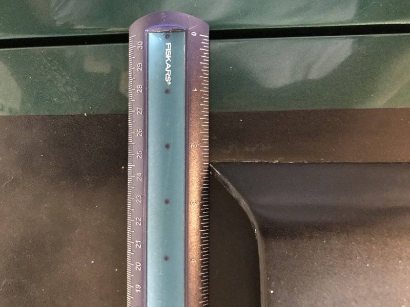

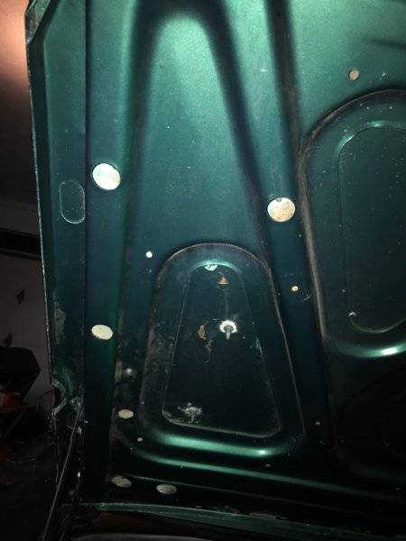

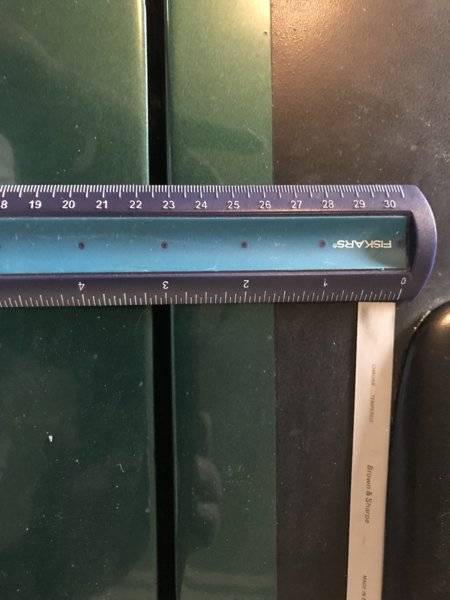

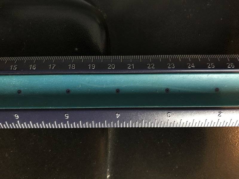

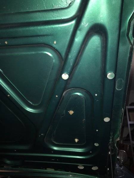

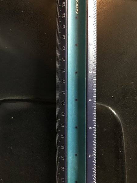

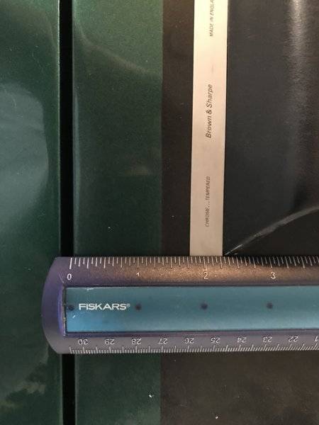

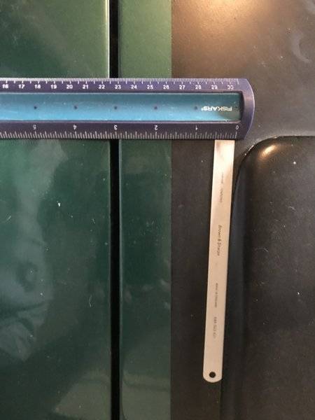

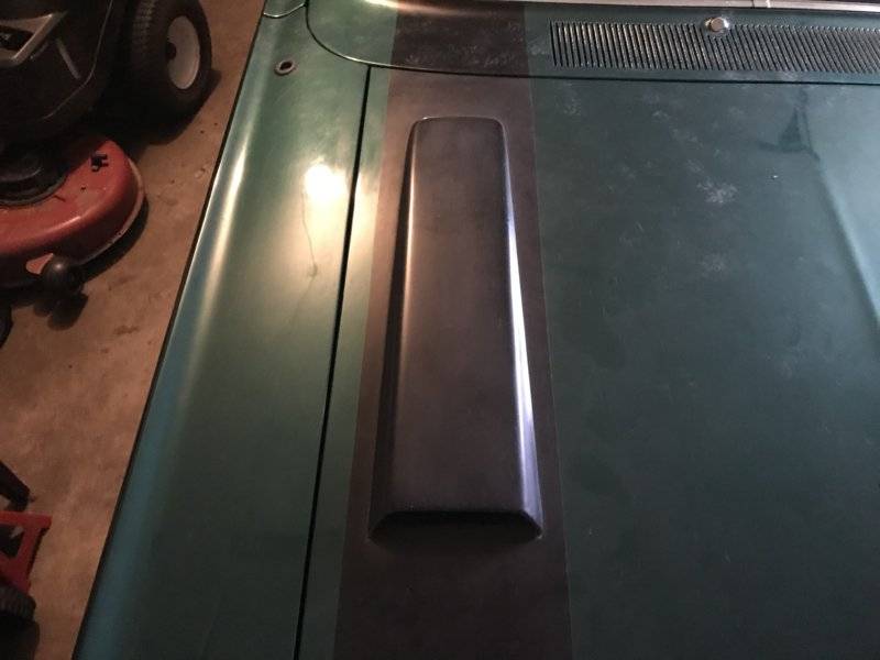

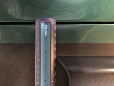

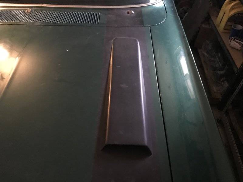

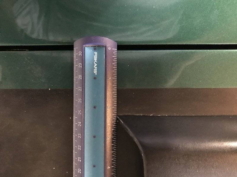

I wonder if someone can help me I’ve just purchased some 67 GTX hood scoops for my Satellite and need to know the correct placement dimensions
As can’t find a template or measurements anywhere.
Thanks in advance
Pauly
Do a search on here Pauly, there's a thread somewhere with photos and dimensions. Cheers
This might help.
-Blake
