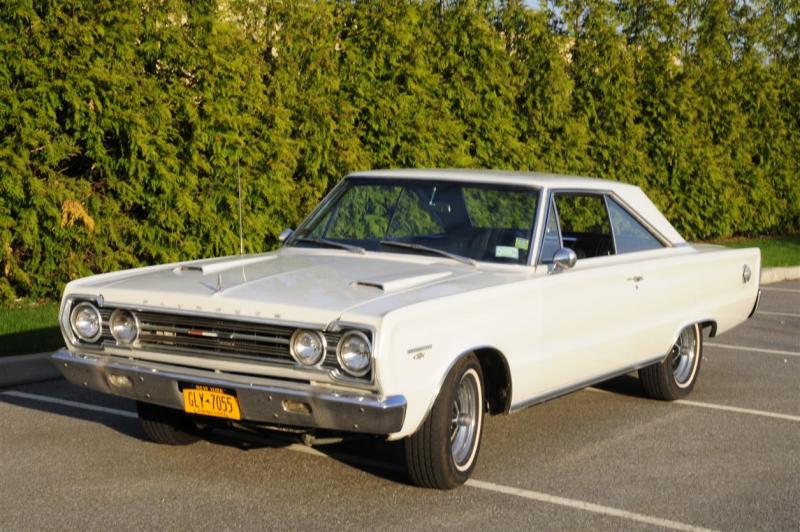

:plane::plane: _DSC7078.jpgHI , MY GTX IS MISSING ITS STRIPES, ACORDING TO THE FENDER TAG, IT SHOULD HAVE "BLACK RACING STRIPES".UBS CODE "B" THE CAR IS MONOTONE WHITE CODE WW1, LOOKS LIKE THE NOSE WAS REPAINTED BACK IT THE EARLY 70'S . I CAN NOT FIND ANY INDICATION THAT THERE WERE STRIPES ON THE REST OFF THE CAR???
IS IT POSSIBLE THE CAR CAME FROM THE FACTORY WITHOUT THE STRIPES EVENTHOUGH THE FENDER TAG SHOWS THE STRIPE CODE "B"?
ANYWAY WHAT THIS ALL COMES DOWN TO IS I WANT TO PUT THE STRIPES BACK ON THE CAR AND NEED TO KNOW THE WIDTH OF THE FACTORY STRIPES , I DONT HAVE OR KNOW ANYONE LOCAL WHO HAS A 67 GTX THAT I COULD MESSURE
SO COULD SOMEONE PLEASE MESSURE THERE GTX STRIPES AND DROP ME A REPLY , I WOULD APPRECIATE IT THANKS AGAIN MOPAR BROTHERS & SISTERS. :sFl_america2:
:plane::plane:View attachment 192868HI , MY GTX IS MISSING ITS STRIPES, ACORDING TO THE FENDER TAG, IT SHOULD HAVE "BLACK RACING STRIPES".UBS CODE "B" THE CAR IS MONOTONE WHITE CODE WW1, LOOKS LIKE THE NOSE WAS REPAINTED BACK IT THE EARLY 70'S . I CAN NOT FIND ANY INDICATION THAT THERE WERE STRIPES ON THE REST OFF THE CAR???

ACORDING TO THE FENDER TAG, IT SHOULD HAVE "BLACK RACING STRIPES".UBS CODE "B" ...IS IT POSSIBLE THE CAR CAME FROM THE FACTORY WITHOUT THE STRIPES EVENTHOUGH THE FENDER TAG SHOWS THE STRIPE CODE "B"?
The 67 GTX stripe code is not under the UBS code. If you are seeing U/B, that means the inner upper door panel was painted black to go with, say, a P6X interior. There should be nothing under the S code.
What is under the PNT code?
if no stripes from the factory the build sheet and maybe the fendertag would be coded "stripe delete"...they did go that way
67 GTX stripes were optional, not standard, so Stripe Delete would not apply.

If you removed the window trim and lifted the rubber trim, you'd likely find the stripes. As shown in the link, they were painted before the window was installed so they go in all the way.
On my GTX the stripe was under the seal, no paint. They were decals, I am curious.
