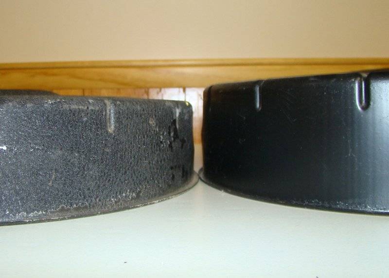

Can anyone tell me the height measurment of the 67 dual snorkel air cleaner? Specifically the 67 GTX and 67 R/T dual snorkel. Thanks
Not sure on height measurement , but that tall one is for a c body
Thanks. Got a line on one but i'm not sure whether it's the taller or shorter model and the owner isn't either. Anyone else know the height measurement?
Might have found the answer in the post. 3 3/8" vs 4".
like stated above the shorter height is correct to avoid touching the hood underside is you use the sound deadener
The one on my 67 GTX is 3-3/8” and just barely clears the hood insulation pad.

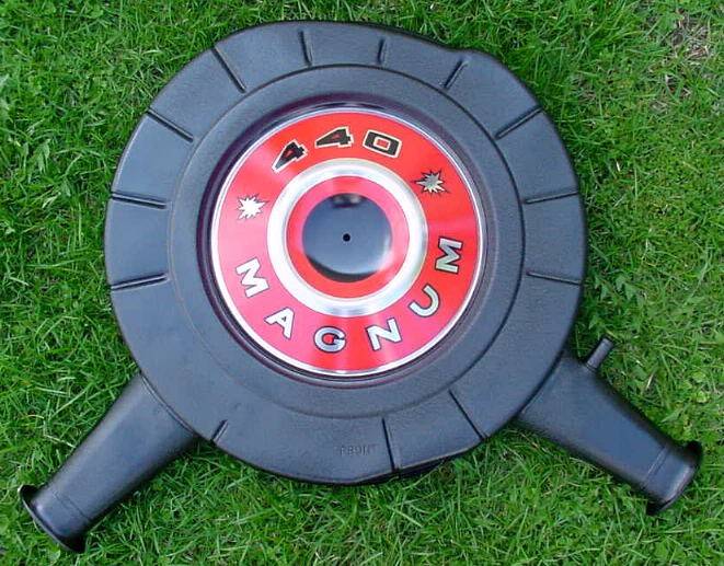

The taller dome does not take the pie pan. You can buy dropped bases at your nearest speed shop, for hood clearance. Then, look for clearance between bottom of lid and coil. You can also juggle height of air filter, if you are using small unsilenced base.

Dangit. The one i located is 4 inches tall so i guess it's for a c body.
The 4” may, or may not take the pie tin. The tall one in the OPs picture will take the Magnum or Super Commando pie tin.
