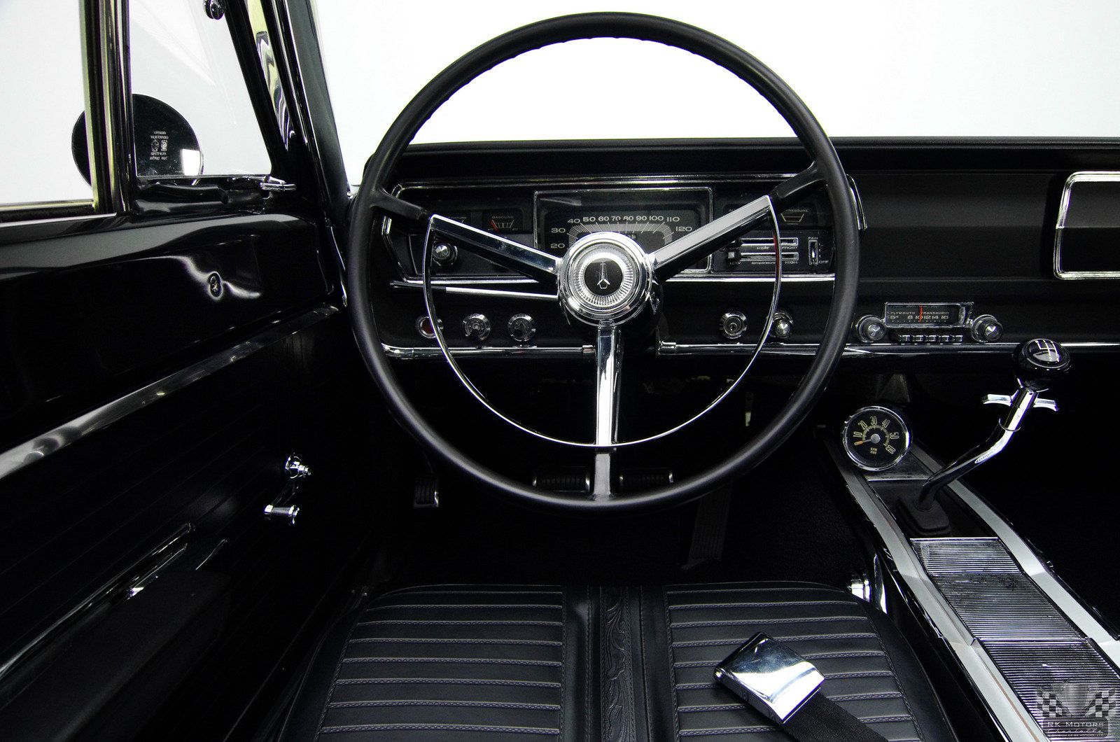

a 1967 Plymouth GTX that has a factory console tach. or a Vacuum tach… It was a special order from acc…..
Wiring….The green lead goes to the distributor negative side, the orange wire is for the internal light, the black wire is the ground, and the violet wire is the positive voltage supply.
Thanks for the drivers seat picture, pops. I have never seen that tach before on a 67, very cool.

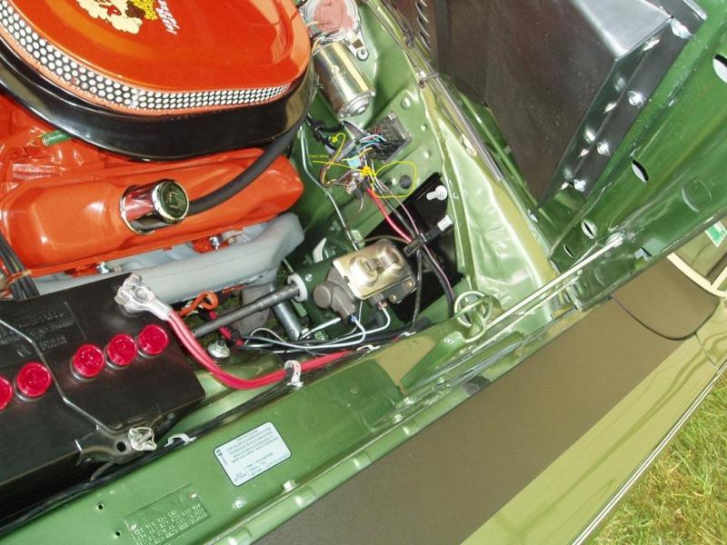

We know what wires go where. What we don't know is where the coil wire goes through the firewall. I know where the coil wire goes through the firewall on 68s & 69s. Does it go through the balk head ?
Again, your service manual will show where the wire goes through the firewall and in what slot on the bulkhead connector
My dad has a 67 manual & it doesn't show where or how it goes through.
Is there a firewall plug with one wire about the size of a quarter? Tack was an accessory which normally was not wired threw the bulkhead.
On my dads 68 gtx there is a plug with the tack wire coming through the firewall. Also there is one on my 69 barracuda coming through about the same area. There is no factory hole in the firewall on my dads 67 gtx for the tack/coil wire.
Yep that is where it is on my dads 68 gtx & my 69 barracuda. No whole there on my dads 67 gtx. Now we know the car came with a tack. M y dad ordered it with a tack.
