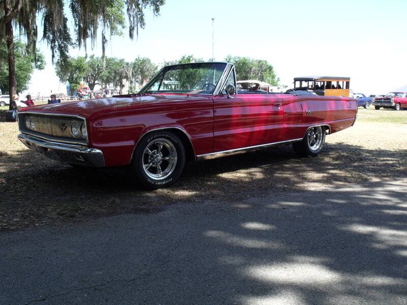

Not sure how close your GTX is to my 67 Coronet, but I have 15 X 8 wheels on the back with a 5 1/4" backspace ( had them made) that to do again I would use a 5 1/8" backspace..... 245 60 15 tires... rubs occasionally

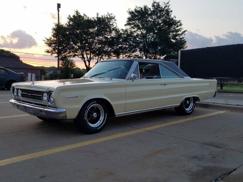

On my '67 Belvedere, I am running a 15"x7" wheel with a 4 1/4" backspace and a 225 70 15 tire. I do not have any interference issues, but I would not want to go ANY bigger. The only difference between my set up and your proposal is you would have 1/8" LESS room. That should work for you, but it will be tight.
15x7 with 4” of backspace on my 67 Belvedere with 255/60/15. No clearance issues with this combo.
