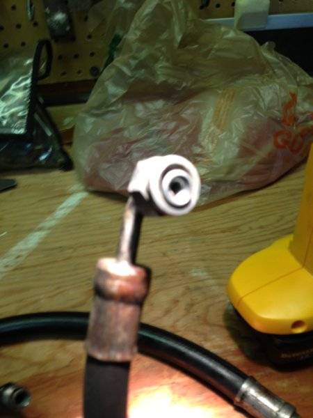

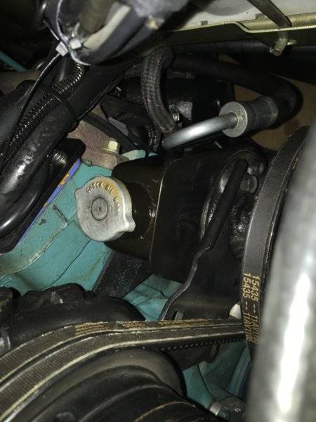

Does anyone have a 66/67 with an original high pressure PS hose still in place. I'm assuming it doesn't look like this one that loops up to within about 2 inches of the radiator support?
I checked with Firm Feel today since I was buying a new PS pump seal kit and described it to him and asked about his replacement. He said it will be the same. I asked, you mean it will loop all the way up by the radiator? He said, Yep - they're all the same. Actually, his whole attitude was sort of as if he couldn't care less if he sold me anything.
Assuming the factory one really didn't look like this - has anyone found a reasonably stock looking one from anyone?
Thanks

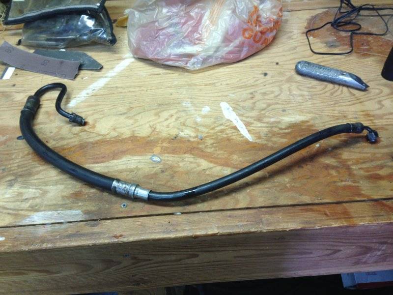

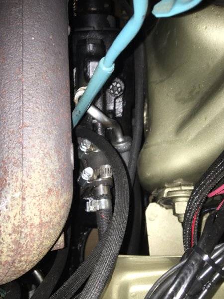

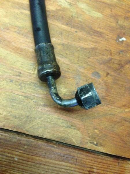

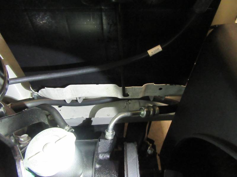

off my 66 Coronet
hose doesn’t run up to rad support but down and back to gear box. maybe you need a shorter hose
it may be a while before i get a number off the hose
watermelon
42537019-3D7E-4840-A6FD-602C57FA5426.jpeg 032F27D8-DCF9-4796-9613-A8DDA615E4C2.jpeg
That's what I would have expected. I wonder if anyone is still stocking the correct hose. Mine looks out of place.
