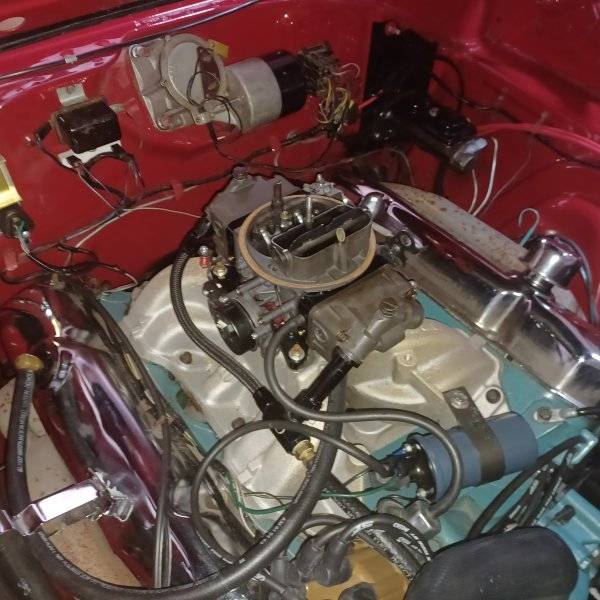

Thanks folks for all your comments on my previous post about the no snorkle air cleaner. I am fairly new to Mopars, so don't know all the details, yet. For example I didn't realize the Holley on the car has a 5 1/8" air horn. Normal AFBs are 4 7/8". So the person who suggested this was an air cleaner off a 1968
C body with a Holley was probably right. After poking all around the internet, it seems the NORMAL air cleaner for a 67 440HP R/T is dual snorkel, no oil breather nipple, and pie pan says 440 MAGNUM on it.
1 - anyone know what kind of Holley this is (pic)? Looks like a big double pumper (yes, I know bad for the street), but I can't for the life of me find any kind of part number anywhere. Intake is Mopar P5153525 that you can get at Summit or Jegs.
2 - I have the original AFB in a box, looks all complete, but has provisions for heat riser choke, which no longer exists with the current manifold

Aftermarket intake and a Holley. Take the air cleaner off and look at the front of the air horn. There should be a "List" number that will tell us what it is.
Normally yes, but no numbers there on this one.
