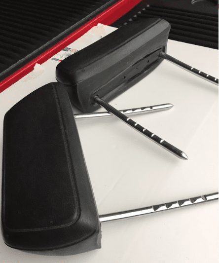

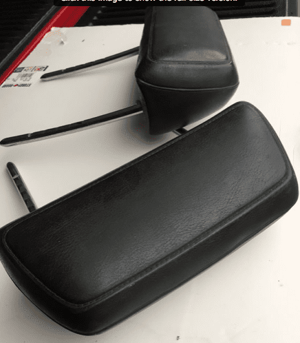

Diplomat style headrests are way off the mark I suppose...
These are 67 only head rests...

Yep. The PGC kit has all the parts needed to install headrests onto 67 bucket seats (and probably bench seats). The issue is that the 67 headrest posts are unique (headrest shape and mounting posts are narrower) AND no one makes repro headrests. I have narrowed a few other headrest mounting posts; I personally just don’t like the look. I’m experimenting with making 67 headrest clones.
Just feeling my 66 buckets, there is nothing rigid (bracket etc) that I could use the kit it doesn't seem. Headrests off 76 Volare bench seat sure look the part but you think the posts are wider spacing heh. I suppose I could tear the Volare seat apart but I'm hesitant to wreck my seats trying to make the Volare set up work
The headrest posts need to be 7 1/2” center to center wide to fit a 67 bucket seat back. Posts are 1/2” solid steel (cold rolled), slight bend and notched (height adjustment stops). Most post assemblies have a plate spot welded atop the horizontal section to provide more surface area to affix the post assembly to headrest head.
As far as I can tell, most headrests of the era are molded (some type of rubber). Headrest was liquid foam filled after post assembly was inserted into molded headrest head. The foam adhered to the inside of headrest and the post assembly.
