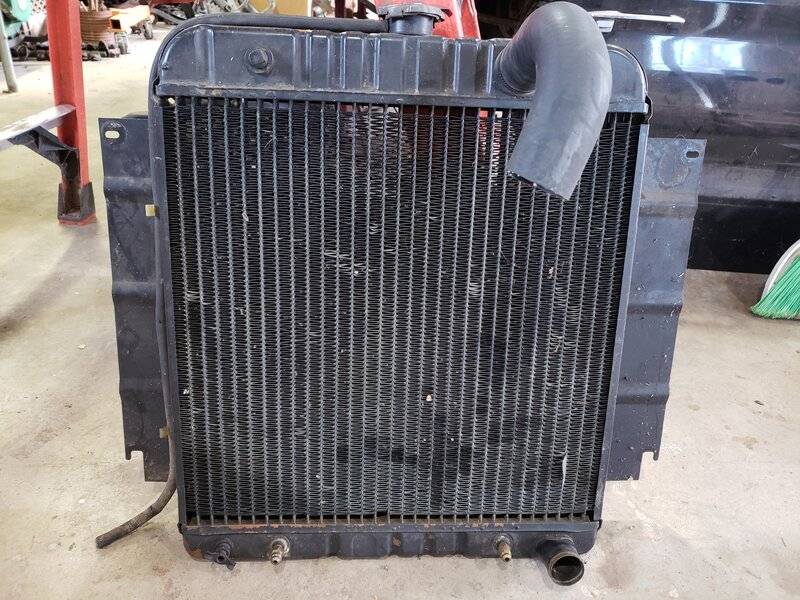

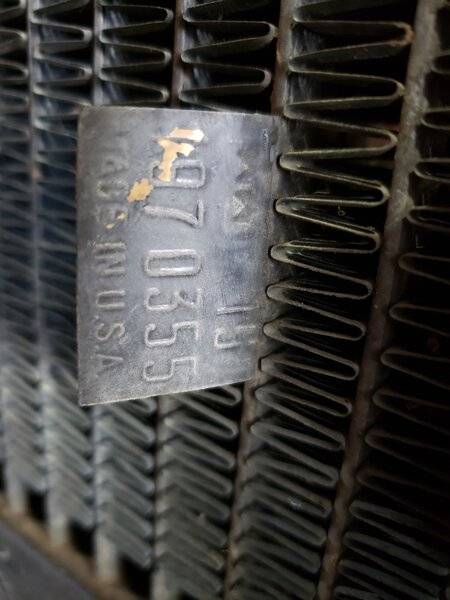

Hello all! It's been way too long since I last posted. I'm attempting to get my project off the ground for the nth time. I've made actual progress for once. I'm in the process of determining what I need for my car. I have my radiator, which came out of a '67 bench seat, auto column shift, no thrills car. I tried to identify this radiator, which I would assume to be a 22" core, but nothing measures 22" on it. I took a pic of the tag on it, and I see the mymopar is now a very different site than I'm used to. Let me know if I'm being dumb on how to look up parts on there. I remember there used to be an extensive set of charts that called out part numbers and application years.... but alas here I am, asking the experts. Thanks in advance! .. again

Not sure from the picture, but I can’t see the the correct holes for mounting studs. That should be a 2785??? Number on the top tank as dadsbee mentioned

That's what I'm confused about... there are no numbers on the top tank. I'm guessing that this is an aftermarket brass radiator??

Looking at the top tank, I'm pretty sure it's some kind of replacement radiator, I will try to get the numbers for a correct radiator, if you provide engine size and transmission.

Thanks for the sanity check. I pulled this out of my /6 904 coronet. I'm dropping a date code correct 440 in it. I was going to put a modern aluminum radiator with e fan...someday. I'm wanting to ID to figure out if it's worth selling or scrapping.

Does your radiator opening on the core support measure 22"? If so Griffin makes a look a like aluminum radiator that will definitely cool that 440. I'm using them in 2 cars.

I agree on a stock or OE build. A 440 didn't come in a /6 car with a 22" opening. I'm sure there are 22" radiators that will probably cool it, but finding one that doesn't need a core could be a problem. Is your 273/318 radiator a 2 or 3 core? Most small block 67's got, 22", but AC cars got 26" radiators.

It looks like a 19" slant six rad to me. They bolt into the same 22" opening that 8 cylinders use.

It does measure 19". I was under the impression that there were only the 22" and 26" radiators. Thanks for the clarification!
