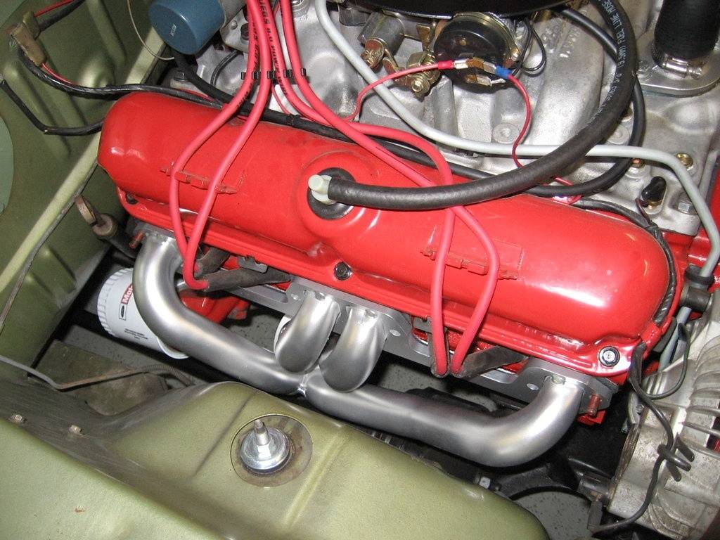

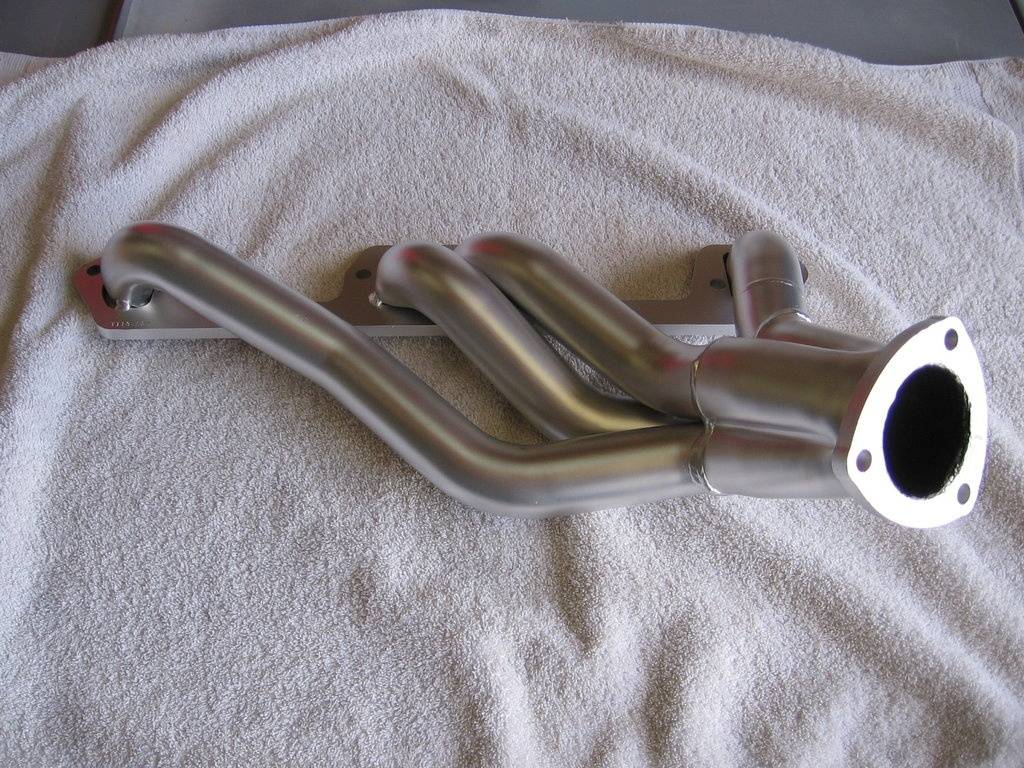

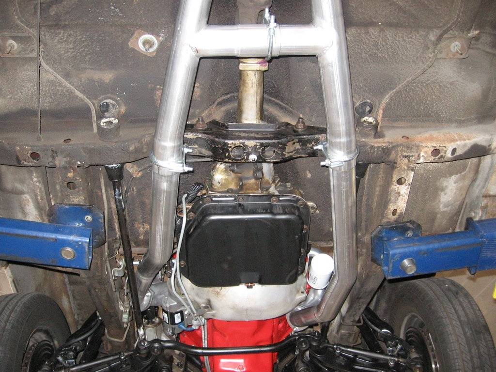

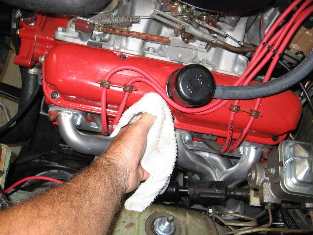

Mega,I am in the middle of a install now using TTI's shorty headers.They are for my 273 68 Valiant. Yes they are expensive, But they are outstanding as far as fit and last the life of the car.The shorty's just dropped right in on the passenger side and from underneath on the driver's. No jacking of the engine or steering parts removal.Over the years I have installed dozen's of headers on all Mopars and I can honestly say after removing the manifolds the headers were in and bolted down in no longer than 10 minutes . The TTI people even give you the option of small or large exhaust port heads IE 273/318 or the 340/360 LA head. I am using the stock 273 heads with the small port header.You will have to install the Mini starter though I think is a good idea anyway. Also their complete dual exhaust system will be installed. A B body will even be easier to install. I plan on posting the install with photo's next week on A Bodies. I'll post a few photo's for you here if you like.Just a thought.

A few photos of TTI shortys.I installed their complete system.
