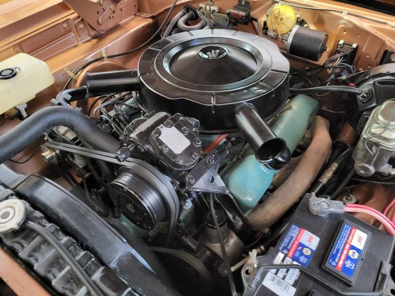

I recently pulled the engine and transmission out of my 1967 Plymouth Satellite for inspection, cleanup and to address some budding issues. I hope some of the resident experts will follow along and chime in as I’m sure I will have questions and be seeking advice. I have a busy day job and other pressing needs around the house/property so my progress may be slow at times, but hopefully you’ll stick with me as I go through it.
This is the original drivetrain to the car which is the high performance “H” code 383 4 bbl, dual exhaust setup backed up by a 727 and a 742 case 3.23 SG. The factory spec for the engine is 10:1 CR, but those specs are known to be “optimistic”. I rebuilt the engine in 1990 while also restoring the car and it has been in the car running since 1992. I drove it from W. Palm Beach, FL to Indy and back for the Mopar Nats in 1993 and 1995 without any issues. Through most of the ‘90’s I also drove it around to car shows in Orlando, Melbourne and Ft. Lauderdale and we still make an annual trek to Daytona Beach. On these trips, it’s not uncommon for me to cruise with traffic on I-95 at around 80 mph, ~3700 RPM without concern. Oil pressure and coolant temp run very steady.

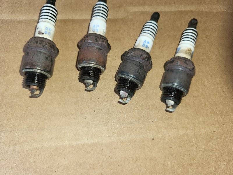

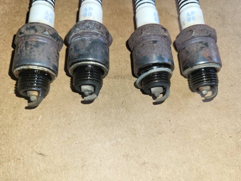

Here are some pictures of the plugs. These have been in for about 10 years but were last checked, cleaned and regapped in late '23. I'm not great at reading them, but didn't see anything too alarming. Interested to know what the experts think so far.

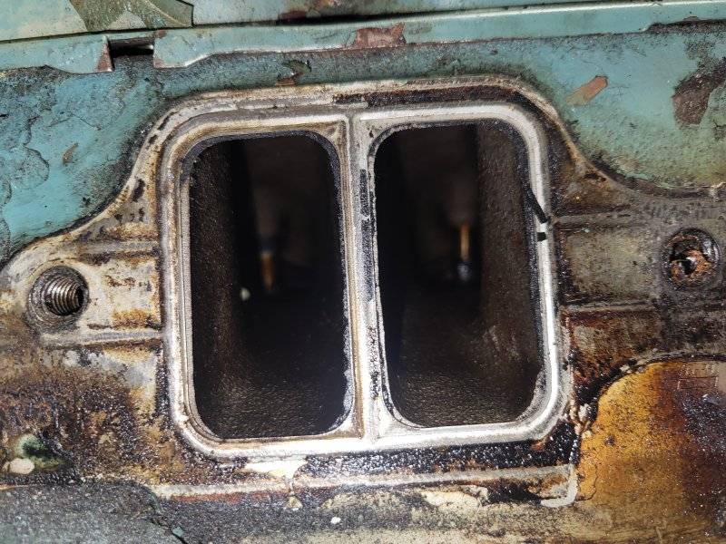

A couple of observations after pulling the intake and valve covers.

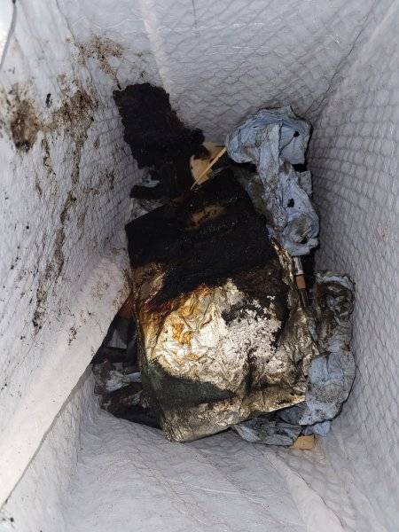

  • The insulation pad between the intake and valley pan was in rough shape. I made this one to replicate the original that I removed during the initial rebuild. It was fiberglass insulation wrapped in heavy duty aluminum foil. It was soaked with oil and the foil had corroded badly.

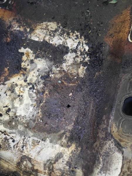

  • There was a small corrosion hole in the valley pan under the insulation pad. Thankfully, there were no obvious signs of water intrusion into the engine likely because I rarely drive this car in the rain, and I am not in the habit of hosing down the engine.
  • The valley pan and heads were wet with oil around the intake ports and the back sides of the intake valves appear to be coked with burnt oil. Thinking this is the most likely source for the oil smoke I have been seeing. There haven’t been any significant indication of oil usage. I change oil and filter annually despite typically driving less than 700 miles annually and it has a few small drips, but dipstick always showed full.

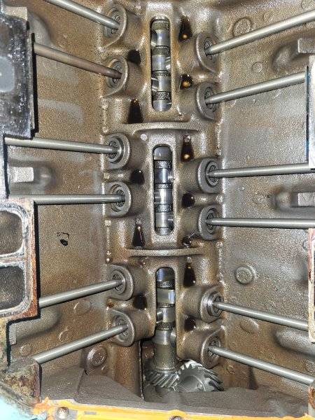

  • Lifter valley, heads and valve covers all look really clean. No deposits or gunk that I can see.

I think you are referring to how the intake seals to the heads and I agree that appears to need some closer inspection and/or work. I did set the intake on without the valley pan and I could not see any gaps between the intake and

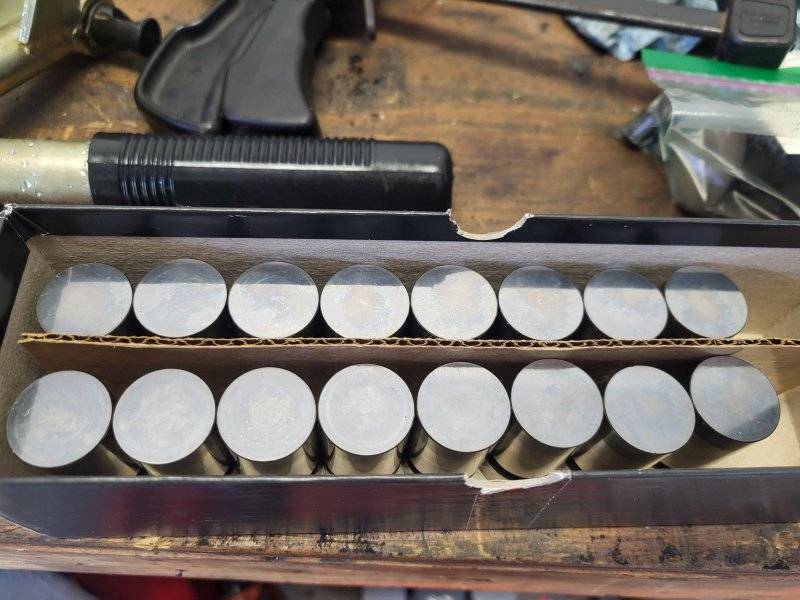

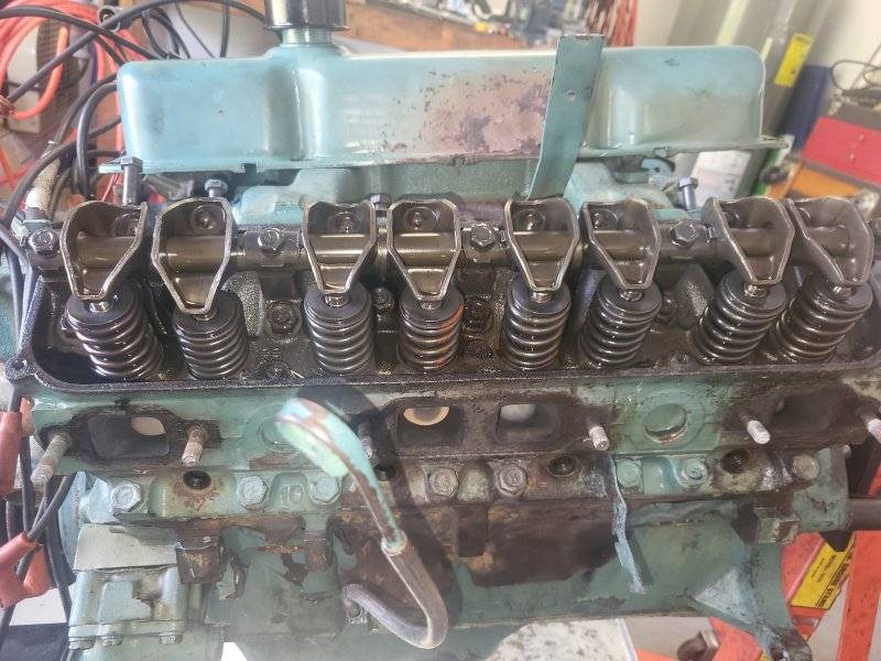

I removed the rocker arms, pushrods and lifters. I didn’t see any concerning wear patterns. One lifter has a barely noticeable circle pattern at about ½ diameter. I can't feel anything on the surface. I still need to check them for curvature. I would like to re-use the cam and lifters so hoping everything checks out there.

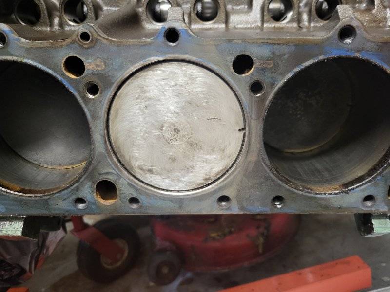

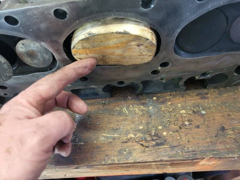

I pulled the heads and found more unexpected things. First thing I noticed is that the pistons are pretty far down the hole. I assembled this engine with what I thought were replacement 10:1 pistons, but I never measured them because it’s not in the FSM and 25 yr old me didn’t know to do that. Couple that with 0.035” head gasket and the milled heads and I thought the engine would be in the 9 - 9.5 Cr range. I cc’ed a couple of chambers and they came in at 80cc. I didn’t cc them before machining so I don’t know how much the shop took off. Thought it was 0.010”, but maybe not. I measured a few pistons and they are about 0.080 - 0.090 down – clearly not 10:1 pistons. All this puts the motor a good point lower in CR than I thought.
I also noticed a ding in the top of #6 piston from the exhaust valve. I’m thinking this the most likely source of the tick I was hearing after the car sat for a while. Glad it didn't turn into anything worse. #5 also has a ding, but that came from the intake valve way back when. Cylinders look good so far, but I haven't inspected them carefully yet. I don't feel any real ridge at the top or see any scoring - I didn't expect any, but this engine has had some surprises so far.

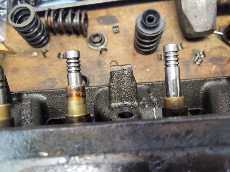

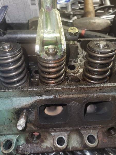

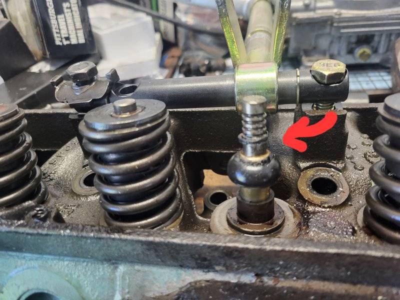

I started breaking down the heads to look at the valve seals, valves, seats, etc. I started with #3 exhaust since that valve was leaking noticeably when I ran the leak-down test. I struggled with it for quite a while. I could not get the retainer to go down more than about an 1/8” and would not clear the locks. I tried all the tricks I could find on the internet as well as advice from my ex-mechanic stepdad, but it still would not break free. I finally cut piece of 1x4 lumber to the shape of the chamber so I could sandwich it between the head and my workbench to hold the valves. I clamped the head to the workbench and used as much force as I could muster using the Comp Cams spring tool with a 15/16 box wrench over the handle to get even more leverage. Still wouldn’t break loose. I whacked the tool a few times with a 3lb hammer while I was pulling down as hard as I could and it finally broke free. I could see why it was so hard to remove after pulling the spring off - the top of the valve seal was chewed up and had left a small o-ring type band of material around the valve stem up under the retainer. I had to force that down the stem to get the retainer to drop low enough to get the locks out.
It wasn’t obvious to me why that seal was chewed up until I removed the spring from #5 exhaust and could see that the bronze guide for #3 was pulled up out of the head compared to #5. I proceeded to remove the springs from the rest of the valves and found all of the exhaust valves were very tight in their guides while all the intakes dropped right out. The only exhaust valves that came out with minimal effort were #2 and #4. The rest will not come out without either using a puller from the valve side or drift from the stem side and several of the guides are loose in the heads – most of the travel on #6, of the dinged piston, is the guide in the head and not the valve in the guide. Not sure what's going on with these, how they got like this or for how long they have been this way. I don't recall having any problems removing/installing them when the machinist had to adjust the intake guide clearances. Not sure if he did anything to the exhaust guides a that time.
All of the valve seals were intact, but the intake seals in particular are cracked and splitting. Definitely time to replace them.
Starting to look like these heads will need some serious work if they are even salvageable. I have 3 other sets of heads in the garage – 2 pair of small valve 915’s, one set of which has had some porting done, but look pretty rough and the other pair are complete, untouched originals. The other pair of heads are bare 906’s that a friend gave me recently. All of these heads will need machine work so I am strongly considering going with a set of 440 Source “Stealth” aluminum heads and possibly their aluminum dual plane intake. The 440 Source heads are spec’ed at 80cc so the CR would stay about the same unless I make other changes like milling the heads or block, changing pistons or some combination. I think I want to get CR closer to 9.5. Any thoughts?
I pulled the heads and found more unexpected things. First thing I noticed is that the pistons are pretty far down the hole. I assembled this engine with what I thought we replacement 10:1 pistons, but I never measured them because it’s not in the FSM and 25 yr old me didn’t know to do that. Couple that with 0.035” head gasket and the milled heads and I thought the engine would be in the 9 - 9.5 Cr range. I cc’ed a couple of chambers on they came in at 80cc. I didn’t cc them machining so I don’t know how much the shop took off. Thought it was 0.010”, but maybe not. I measured a few pistons and they are about 0.080 - 0.090 down – clearly not 10:1 pistons. All this puts the motor a good point lower in CR than I thought.

Your guides were clearly too tight causing the valves to stick in the guides. Bronze guides can be run a bit tighter than iron but i wouldnt want any less than .002 clearance myself.

I cleaned up the top of the pistons and block to take measurements of the piston to deck height. They are 0.090" on average +/- a couple of thousandandths. So I calculate 8.27 CR. Not what I thought I had or wanted.

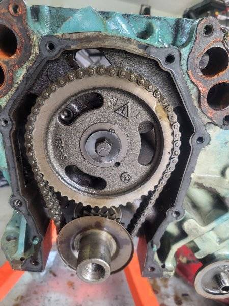

Dropped the oil pan and I can see a small amount of glitter in the oil. Camera seems to show more than my eyes see. I plan to swish a magnet around in it and see what it picks up. I also plan to carefully cut open the oil filter and have a look there as well.
Timing set still looks tight and block is clean inside.
