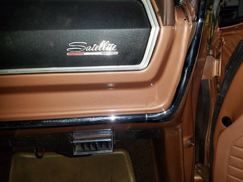

Does anyone know if the trim that goes down the side and across the bottom of the dash is chrome or stainless? Trying to determine whether it can be polished or if it has to be replated. Thanks.

No worries, thanks for the reply. Trying to help another member with their project. Just realized I could see if it was magnetic and it is which rules out most stainless.

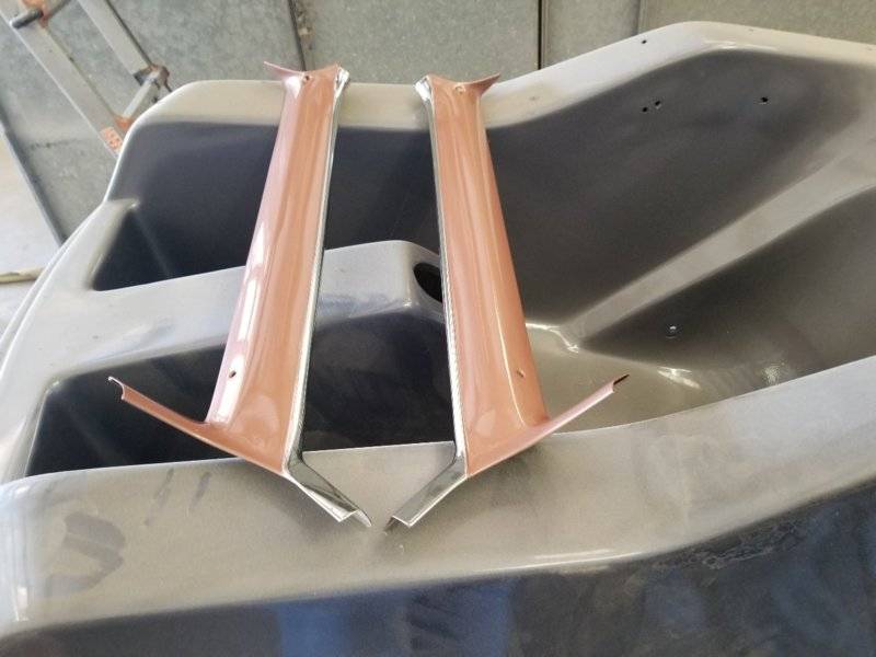

I painted these as the only chrome that cleaned up good was the edges. It's also on a Coronet 500. Probably incorrect, but looks great.

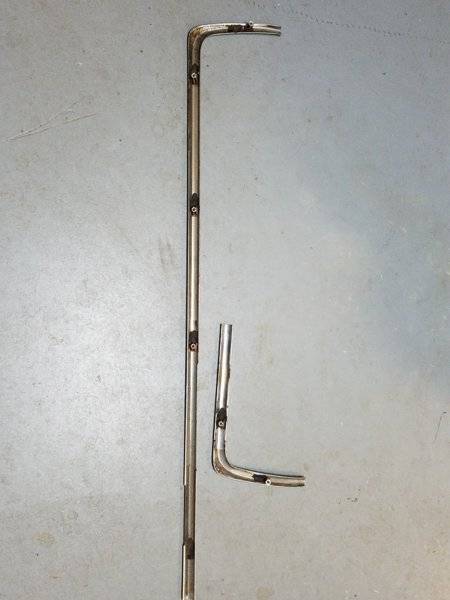

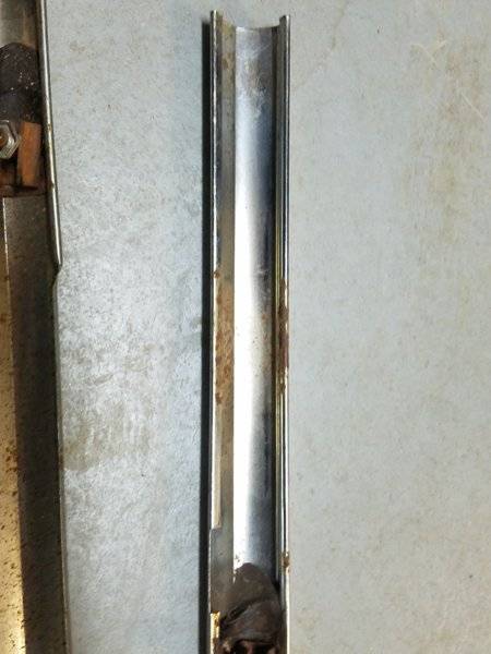

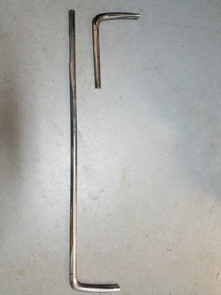

Thanks to all for the replies. Anyone have an idea of what a used set of this trim is worth? The chrome on the spare set I have looks a little splotchy and there is a bit of rust in a few spots along the back and upper/lower edges, but itis otherwise free of pits, dents, etc. Probably ok for a driver, but likely needs rechromed for a nice show car. Haven't decided if I want to part with these, but another member may be interested in buying and I haven't found anything similar to set a price. Thanks in advance ...

That trim is chrome plated. The long straight piece is different from Dodge to Plymouth, it is notched for the radio and ash tray. Both pieces that end at the column opening are different from 66 to 67.

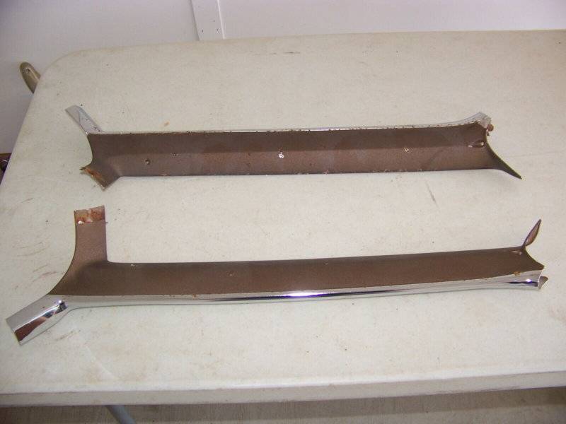

R413 - These are the A Pillar parts of which you speak for '66. Mine are going out to be replated. Would you know the proper paint used for these parts and the upper windshield interior trim?

If there is small rust spots on the lower dash chrome, they can be taken out. It is time consuming.
I started with 1000 wet/dry sandpaper. Then decided if I needed to drop down or not. Some of the stainless is magnetic, and some is not.
Most of the trim I have done for the Charger is sanded with 2000 grit, some 2500 grit, then buffed.
If you want pictures, I will have get help to load and send. I didn’t take before pictures.
The 66 lower chrome is longer than 67, both brands. So a 66 can be cut shorter to work in a 67.

so is it for sale?
Yes, I will sell these parts. Both of my cars have nicer trim so it's unlikely I will need them. Might be difficult to ship due to the size.

The partially painted A Pillar trim (post 10) is only on 1966 2 door hardtop cars. 1967 was all chrome.

If you strip the paint off the 66 A pillar mouldings, they become 67 mouldings, usually here, you won’t find rust behind the painted pillar.
