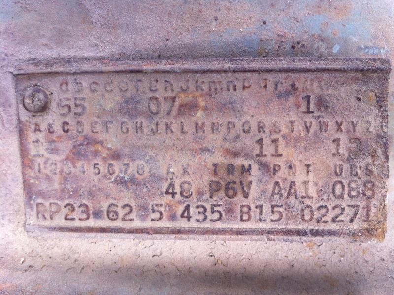

I would need pic of tag to tell you the rest. If ya have to, take tag off and turn it over & read the back, the letters & numbers will be more clear
Bryan
It looks like Q88, ill try to upload a pic....

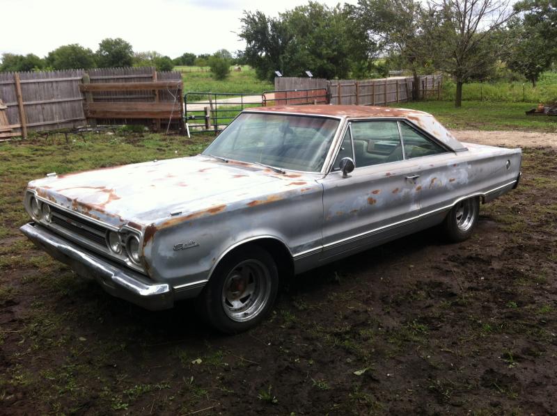

Ill be getting pics of her shortly, she still has her orig silver paint, although the paint has seen better days

Here she is in her...former? Glory.

I'll take it.
Sure looks like "88".
Was it the lower body color?
Wasn't that black or gray on Satellites?
Yours could have been a one color car?
Because its still wearing a lot of its orig paint, i agree with you, the whole car looks silver, so I'm not sure where the Q=dark red, is even present, I don't see dark red anywhere (?), the first 8=stripe delete, makes sense because I don't see any signs of a lower body stripe
DUH!
I got the codes reversed,
UBS
Q88
should be Q=Dark red (still don't see any darke red tho?)
8=AA1 metallic silver paint (correct?)
8=stripe delete
there ya go...that sounds better
the "Q" would be for upper door frame paint..which should relate to the painted portion of door in front of door panel....inside the car, not on the outside
AA1 is silver, yes
Yes sir, I believe that's it.
the upper door frames on the inside are red, so youre correct again, that's the Q code.
