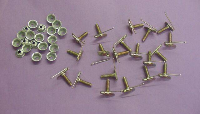

I would have to go out to my shed to see if they are in my bent finish panel. But do these look like what you are talking about?
https://www.ebay.com/i/301735283257...MIrKWHkJW66AIVJIVaBR3poQpfEAkYBiABEgJq4_D_BwE

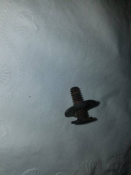

I have some spares I can send you. You need 4?
View attachment 927785 7
YES, those are the ones. I have been searching for over a year now. I do need 4 to complete the restore of my trunk lid tail piece. If you can please send to

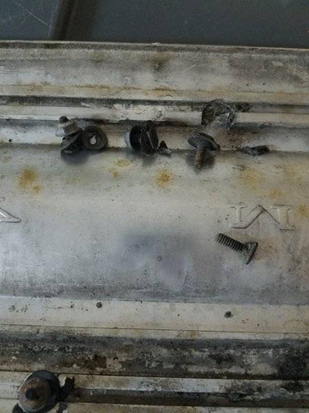

There seems to be a thin paper or plastic "washer" on these - I need to look closer I broke one before I realized it was there. I'll try to preserve them, but they are brittle. Need to figure out the best way to send them. Without the washer, I can probably just put the bolts in an envelope.

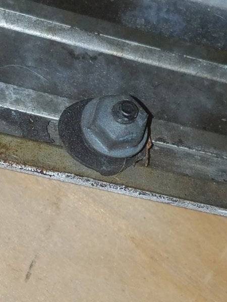

Here's what the washer looks like. It goes between the finish panel and the deck lid.

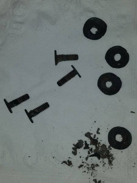

I chipped away the old, dried putty and was able to separate the washers from the bolts which will make them easier to mail. The washers appear to be soft plastic or something, almost rubbery.
I'll send you a couple washers so you can see what they look like.
Looking at these and thinking about it a little more, gasket is probably a better description than washer...my guess is that these are supposed to seal the mounting holes in the deck lid. Can probably just use a dab of RTV on each stud.
