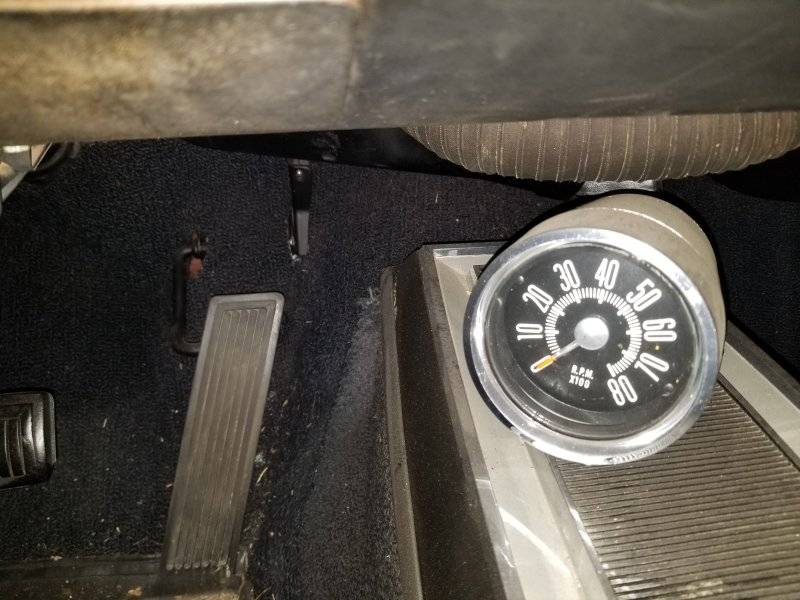

Please tell me the code. I ordered my first 67 new and the salesman went down the option list item by item. You could be right, but the only thing I learned from this opportunity was that 2 optional tachometers were available in 67. A 6K and a 8K console tachometer. Seatbelts were never mentioned other than the vehicle was equipped with them.

Please tell me the code. I ordered my first 67 new and the salesman went down the option list item by item. You could be right, but the only thing I learned from this opportunity was that 2 optional tachometers were available in 67. A 6K and a 8K console tachometer. Seatbelts were never mentioned other than the vehicle was equipped with them.View attachment 1886567
That might be a problem. I had those on a list sent to me, or I copied it years ago. It listed so many things. Example left side headrest. Left side headrest.pair of headrests. Seat belts and other things. I will try to dig deep to find it.
