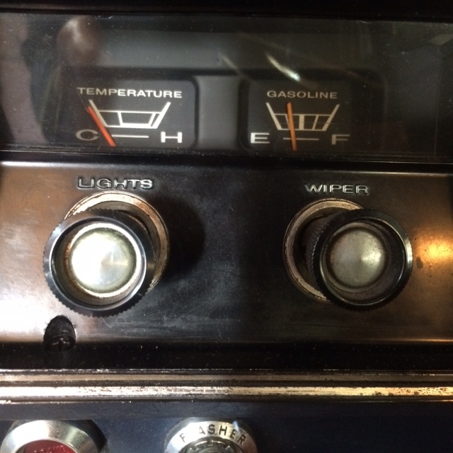

Just checking to be sure. Will the light knob and wiper knob just pull off with a little pressure?
See Pic. Thanks.
Thanks.
The wiper knob pulls off. The headlight knob you have to push in a button on light switch to pull out knob and shaft. I believe you pull light switch to on position then push button on switch behind dash, then pull knob out.
That is correct.
