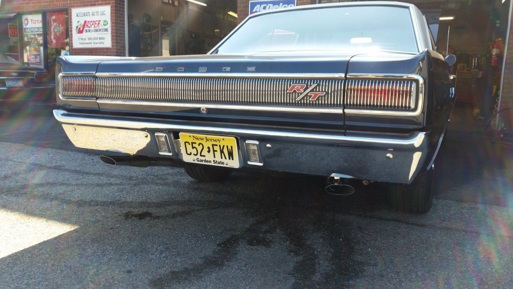

I'm crazy for the looks of the 67 GTX exhaust tail pipes and tips. I really would love to have that exhaust system on my 67 Coronet RT. I can't get any of the exhaust manufacturers to say it will work. Only area of concern is the fuel tank fill pipe and hose. Is it identical to that of the GTX? If both car are the same in that area it should be ok. Could any member comment or a 67 GTX owner post a picture or two of the left tail pipe and chrome tip in relation to the fill pipe.
Should work. Outside skins are different...about it.

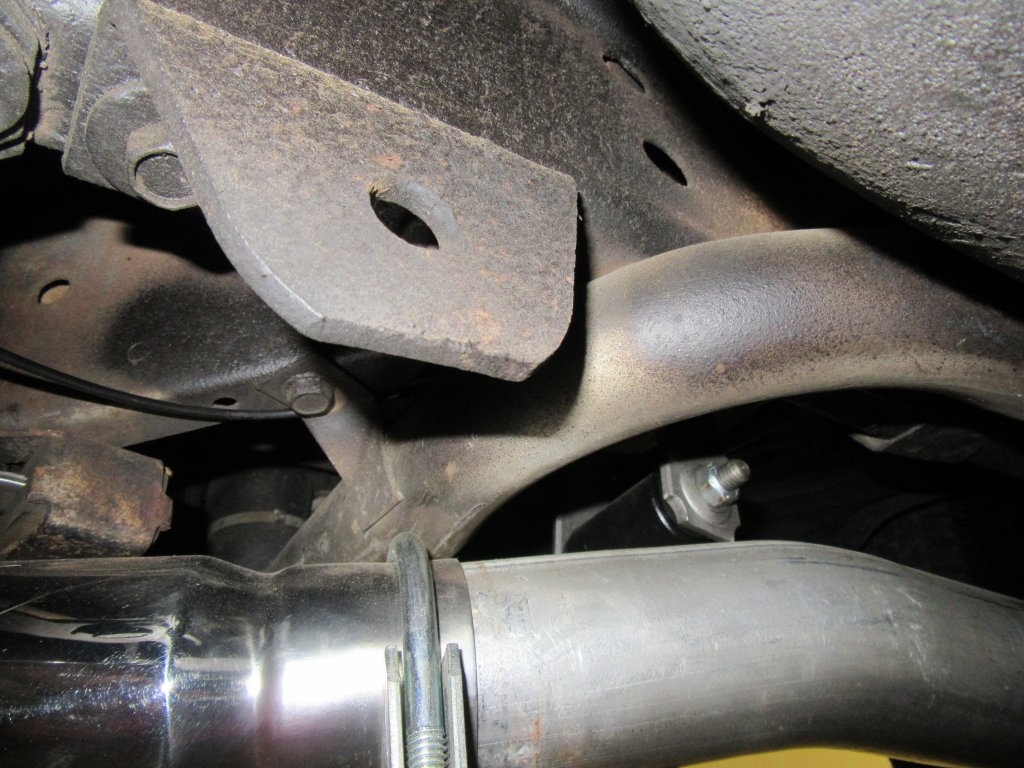

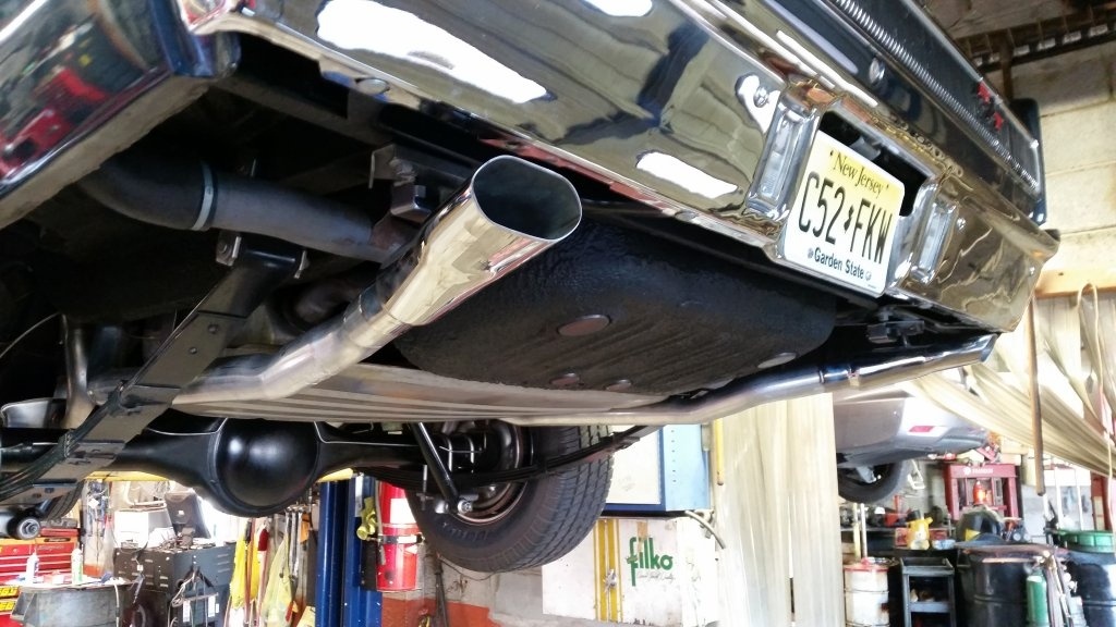

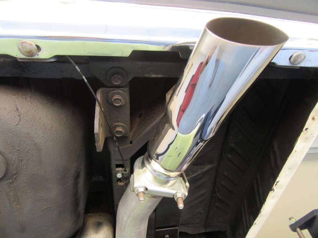

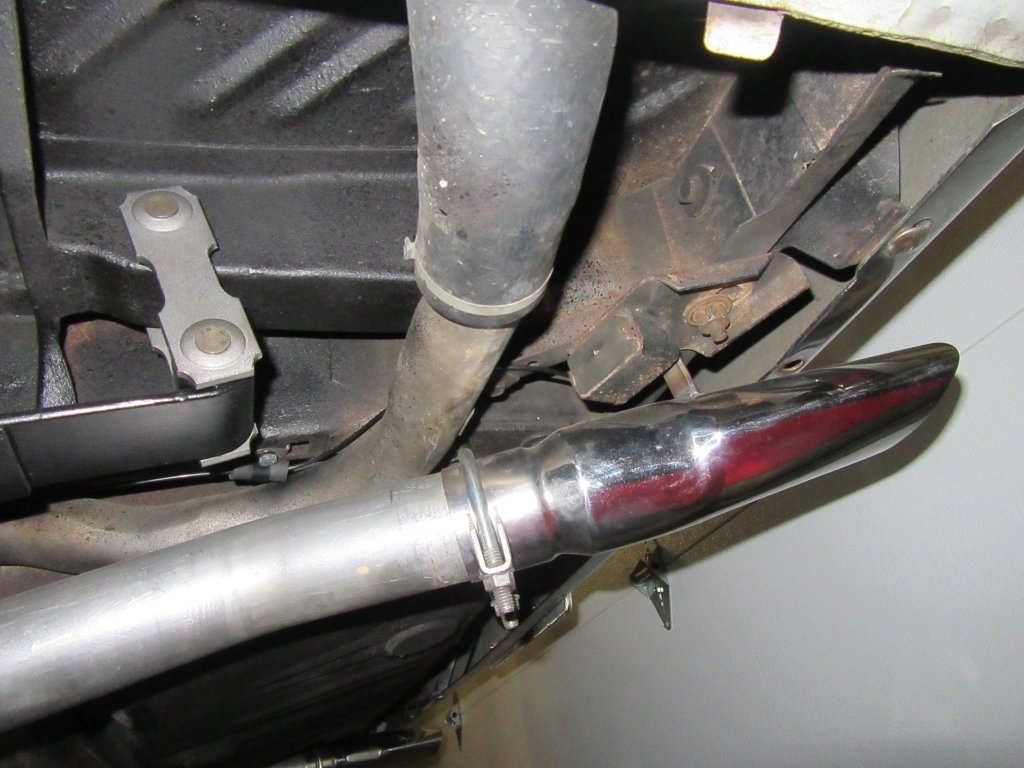

Maybe these will help. I have about 3/4 inch clearance to the fill pipe but I'm running 2-1/2 inch TTI tail pipes. You need the correct GTX tailpipe hangars for the tips also.

thanks for the pics now I have some thing to compare

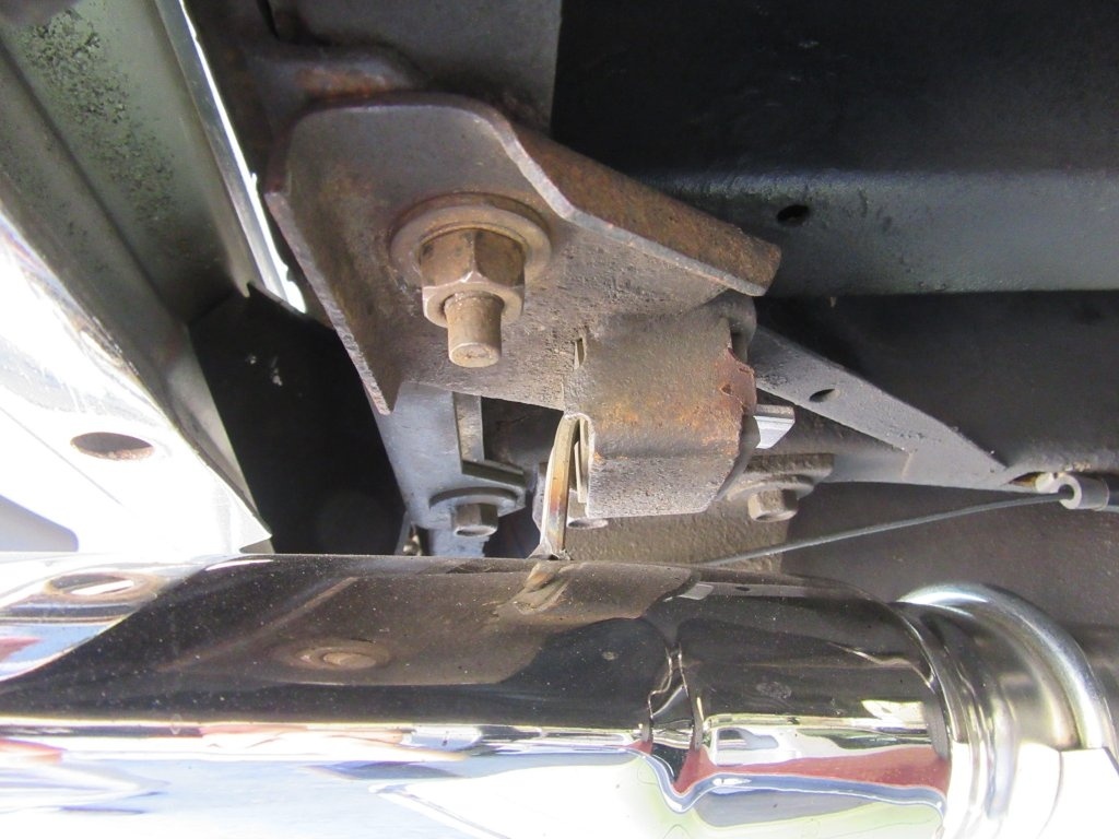

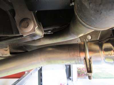

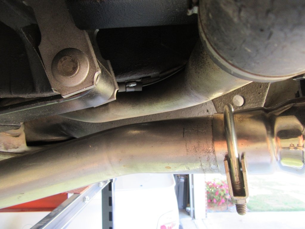

I put my car up on a lift today so if you need a specific measurement or a better photo I can probably get it for you.
If I could get a pic showing the tip hanger mounting location that would be great
I'll get it today. I have TTI tailpipes and tips but from memory I used the original hangars because they seemed to fit better than what TTI sent me.

Here are the additional pictures that are of better detail.
Thank you big help, i ordered the parts I'll post photos when it's all done
