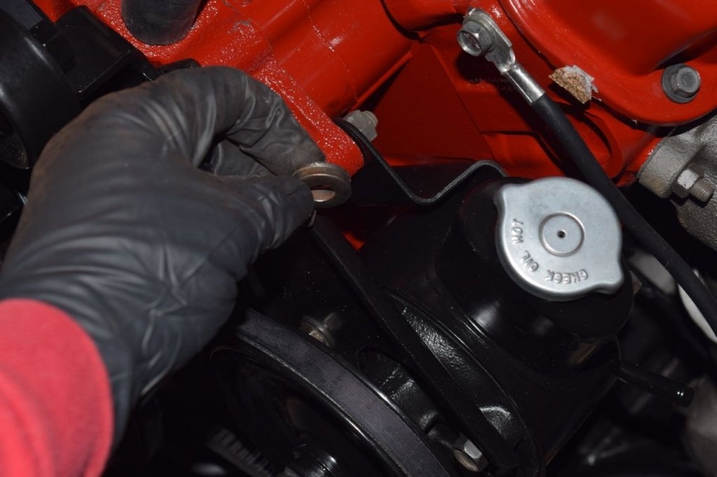

I have a part left over when reassembling my 318 with PS/AC. This fat washer was with the PS bracket parts and I can't find a photo of my disassembly of where this thing went. It seems special...

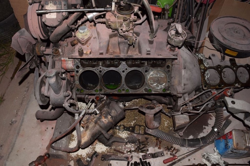

Found a photo that explains it... Notice how many threads are showing between the upper and lower back studs. The bottom one barely has one thread showing from the nut. The fat washer goes between the pump and the bracket on this stud.
Glad you found it; my 1st guess would have been for belt - pulley alignment.
