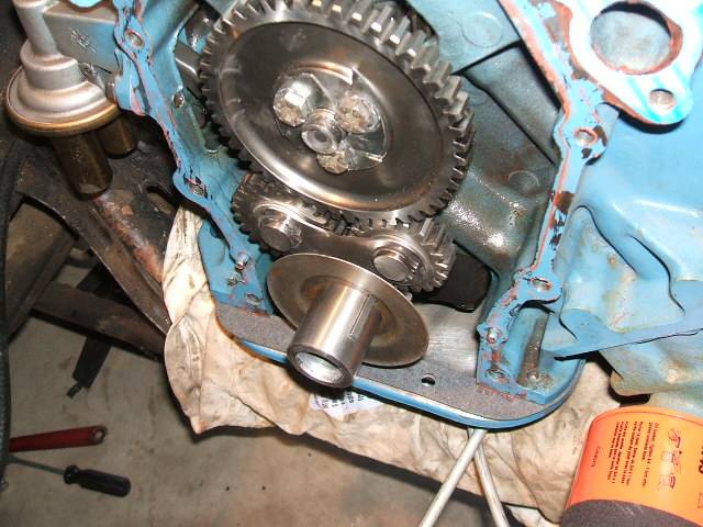

Here:
Kern is correct! If you install it facing the other direction it will eat your timing chain.
Thanks. So if it can slide all the way up against the timing chain, that's cool?
No, against the crank gear. There is a "step" to the slinger, an offset. The offset goes away from the gear.

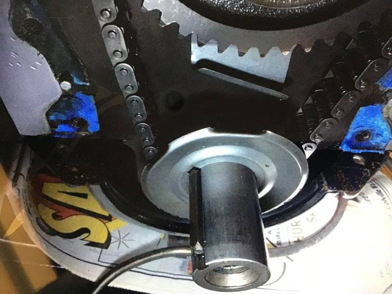

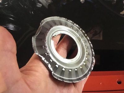

It should never touch the chain. Do like the photo above or this will happen. Metal maker.
Yes it’s a bit loose on the crank, thy all are. The balancer holds it tight to the lower gear, it’s. Not loose anymore.

I guess those should be stamped with THIS SIDE OUT !

Dunno, but this guy would have been dollars ahead to just throw his away!! :bananaweed:
