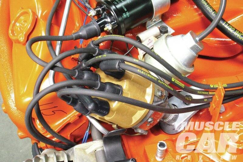

I use the 90's for 1-3-5 and a straight one for 7. The 2-4-6-8 wires are all straight.
Thanks much! Any thoughts on the 2 straight spark plug boots? I thought they both went at the rear of the engine (#7 and #8)
Thanks. Your photo appears to show a straight plug boot at #8?

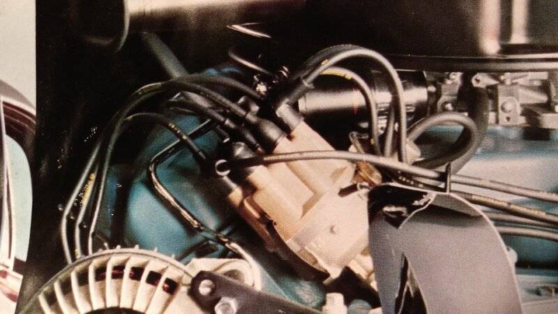

68 383 from the sales brochure
Sorry turbine, I don't remember any 90 boots on the cap. Too many brews(?),don't know.

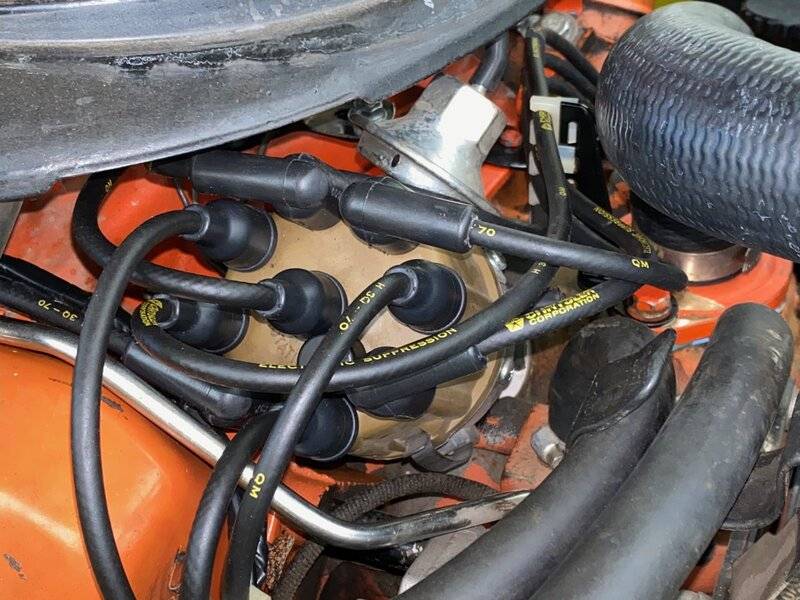

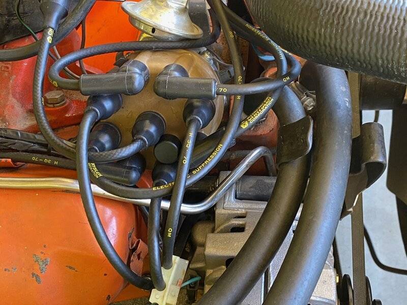

I think 1, 2,4,6, and coil are straight. 8, 3, 5, 7 are 90’d on mine. 69.kinda hard to see here. Will get a better pic for you.

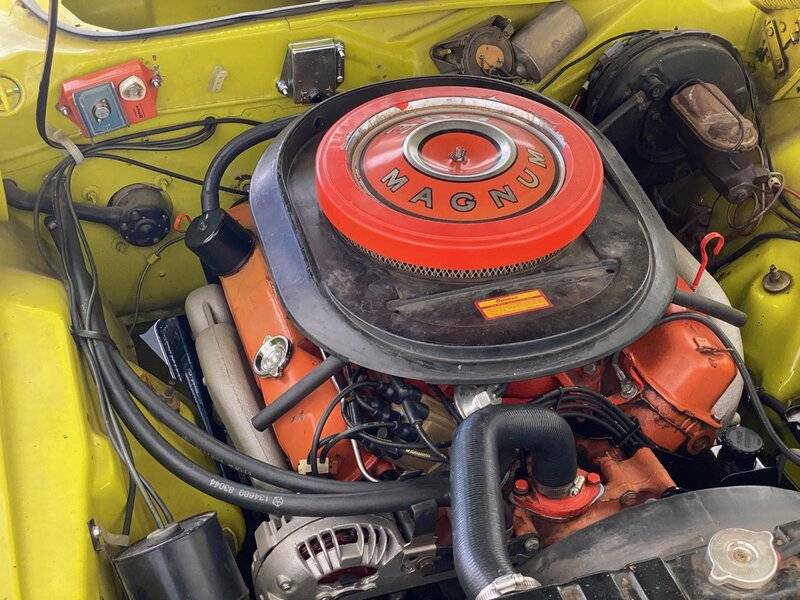

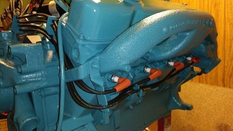

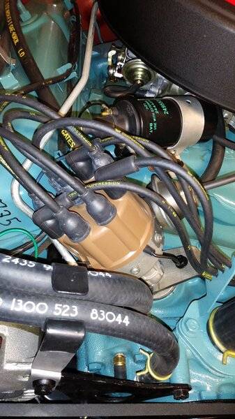

Here are photos of the engine, of what some consider to be the finest example, of a survivor 1971 Charger Super Bee 383 Magnum in existence. Note the placement of the factory Chrysler, date code correct, plugs wires on the distributor cap, of this incredible example of a Mopar muscle car.. These photos should be in a restoration reference book!
On distributor cap, four 90 degree boots and four straight boots. On spark plugs, all 90 degree orange boots. Even though included paperwork with these incredible wires stated #8 plug boot was 135 degrees or something like that..

Are #4 and #7 reversed?
