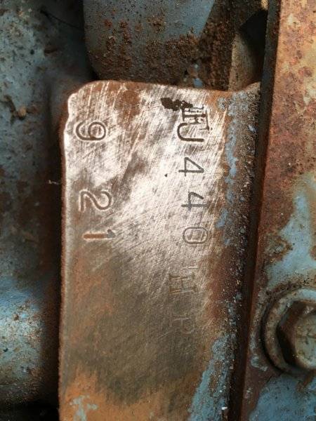

I wonder if I can get a little assistance. This is on my 1970 GTX front engine pad, thanks

J440= '73 440
Am I wrong guys or do those F and HP stamps not look right. Like a different font than what the factory typically used?
The 'J440' looks factory.
J440= '73 440
They look different... and I'm surprised they had an HP engine in 73.
I didn't think they did..maybe I'm wrong?
Unfortunately it looks like someone got stamp happy at some point in time.

I noticed that also. Actually if you look at the "font" of the F and the HP, they look the same. It looks to me like the "J" is out of place. One guess is that the engine was rebuilt / replaced when it was under warranty and they added that at that time.

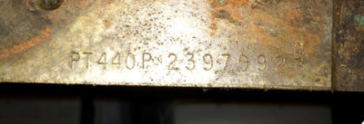

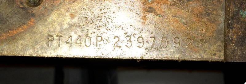

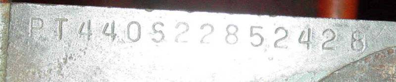

Pan rail should have a plant stamp PT is Trenton. second letter, "P" for premium fuel "S" special -R/T

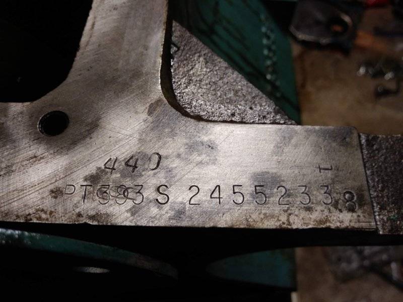

Here's one from the "nobody's perfect" dept. This is my numbers matching 440. Looks like someone thought this was a 383 at first and realized it needed a slight correction.
