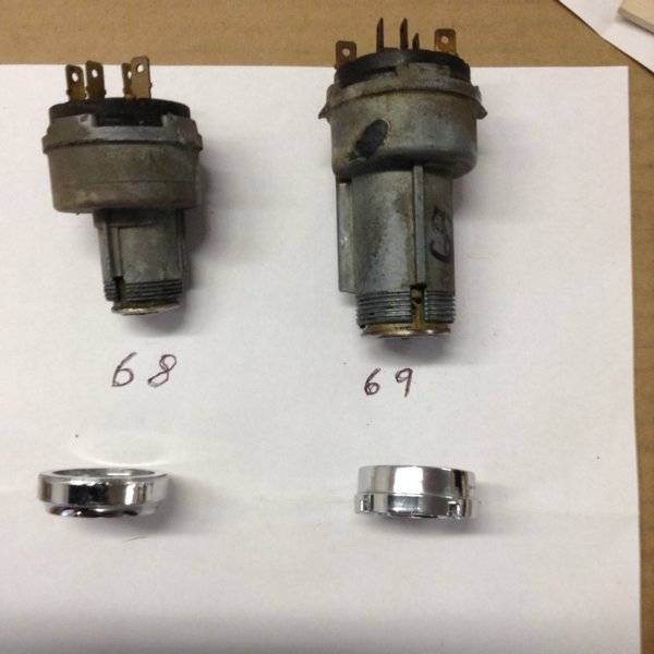

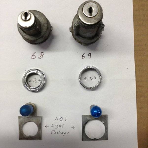

Can some one clue me in on the necessary information to find a correct ignition switch and bezel for a '68 'X? I have an OE one from a '69 'X and do understand that they are different from a 68.
I see a lot of conflicting info and offerings out there on fleabay for example.
So what is up with the bezels, dash hole size, terminal arrangements, part numbers, repop offerings, etc
Any help would be appreciated.
thanks
Brian
69 has a bigger key cylinder so dash opening is inch and an 8th. 68 dash opening 7/8th terminals are the same allthough I have seen a 68 with out the ground terminal.
I have a 68 Switch with the key, PM me if interested
